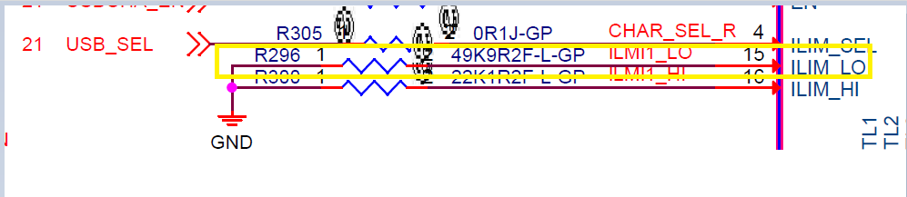

2. If I changed the ILIM_LO resistor from 49k to 2Mohm, then when Status# S0(With device) into S3/S4/S5,
TPS2546 pin9 will be low-->high-->low. Is that correct?

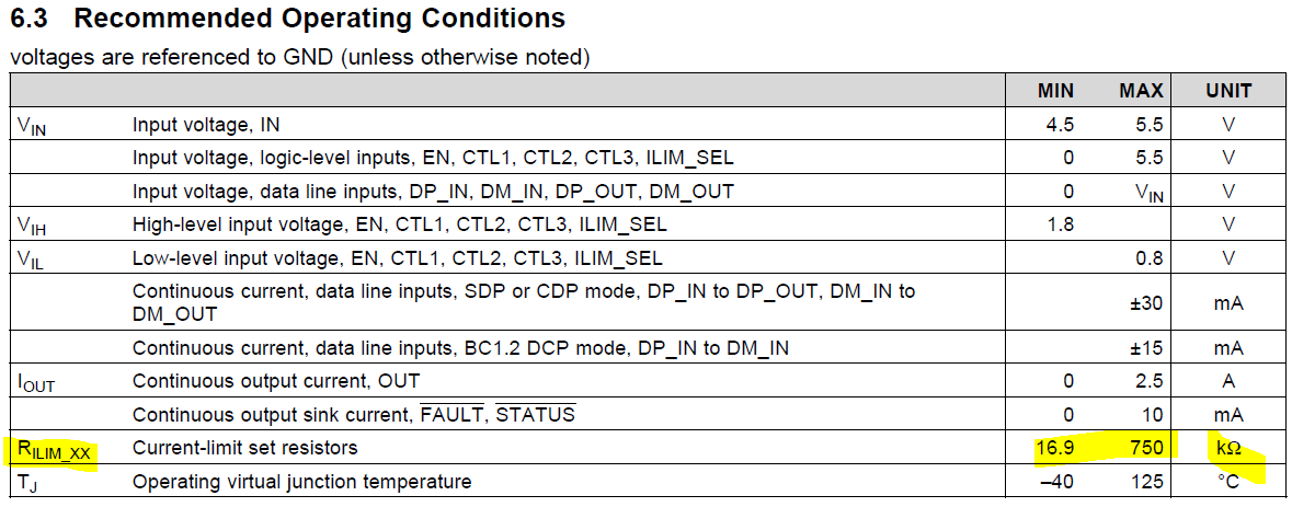

3. From datasheet, the resistor range is 16.9K~750K, is that ok to put 2Mohm?
4. When I put ILIM_LO resistor=49k, and do Status# S0(With device) into S3/S4/S5, why pin9 STATUS can't be low?

    2. If I changed the ILIM_LO resistor from 49k to 2Mohm, then when Status# S0(With device) into S3/S4/S5, TPS2546 pin9 will be low-->high-->low. Is that correct?
    RILIM_LO must be set in the range listed, between 16.9k and 750k, if you want to use load detection.
    See above answer.
    What CTL inputs do you have? Please check the Table 3 in the datasheet to ensure this mode offers STATUS output.

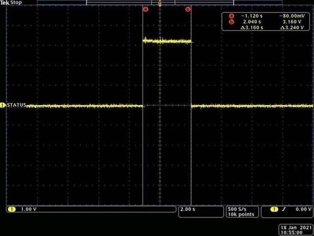

    1. When they connect different load device, they will see the STATUS high time is different, they feedback the CTL1~ILIM_SEL level in the third waveform. We should ask them to check the load current level to see if it hit the threshold and change the STATUS pin? They wonder why in the 0111 stage, will see STATUS high and then later keep low?

    1. The STATUS pin uses the ILIM_LO resistor for low current-limit threshold and the load detection current threshold. The STATUS pin is asserted in load detection conditions so the resistor being used for ILIM_LO could be playing a part in why STATUS is on the boarder of being asserted. Depending on where the connected device is in its charging period, it will be pulling different amounts of current which will assert/deassert STATUS. It is up to the setting of the ILIM_LO resistor to decide what current level should assert STATUS.
    2. The VBUS/VOUT drop is not related to STATUS. When the TPS2546 changes modes, VBUS is discharged so that the connected device can go through the proper enumeration so that it can be in the correct mode. When VBUS is discharged, STATUS will go back to not being asserted. This is expected behavior.

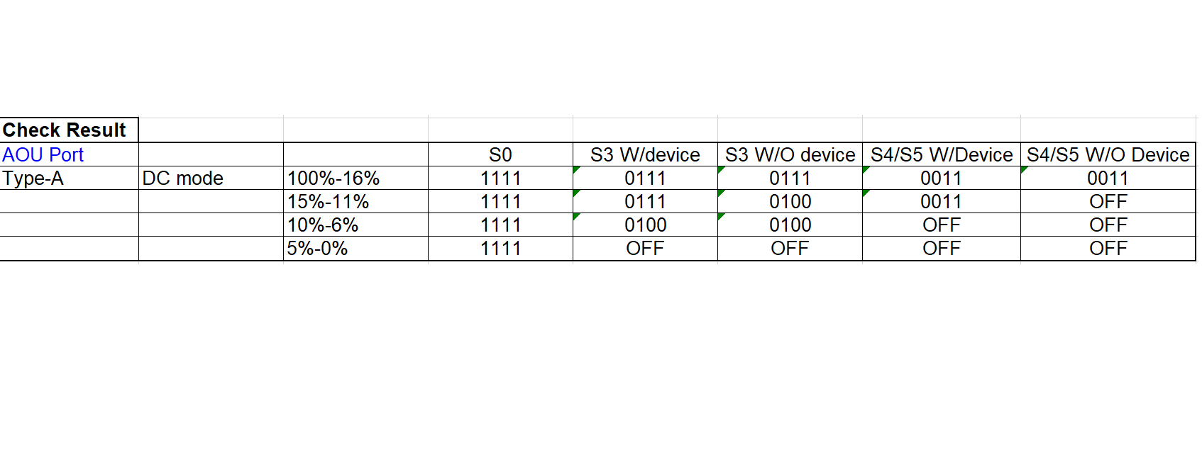

    truth table sequence:CTL1→CTL2→CTL3→ILIM_SEL
    I am not sure what this table means? Can you clarify what you would like me to check?

  • Hi Emma
    Sorry, probably I didn't explain it clear enough and caused your misunderstanding.

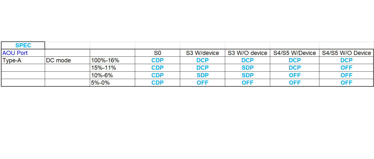

    Customer require charging mode below table

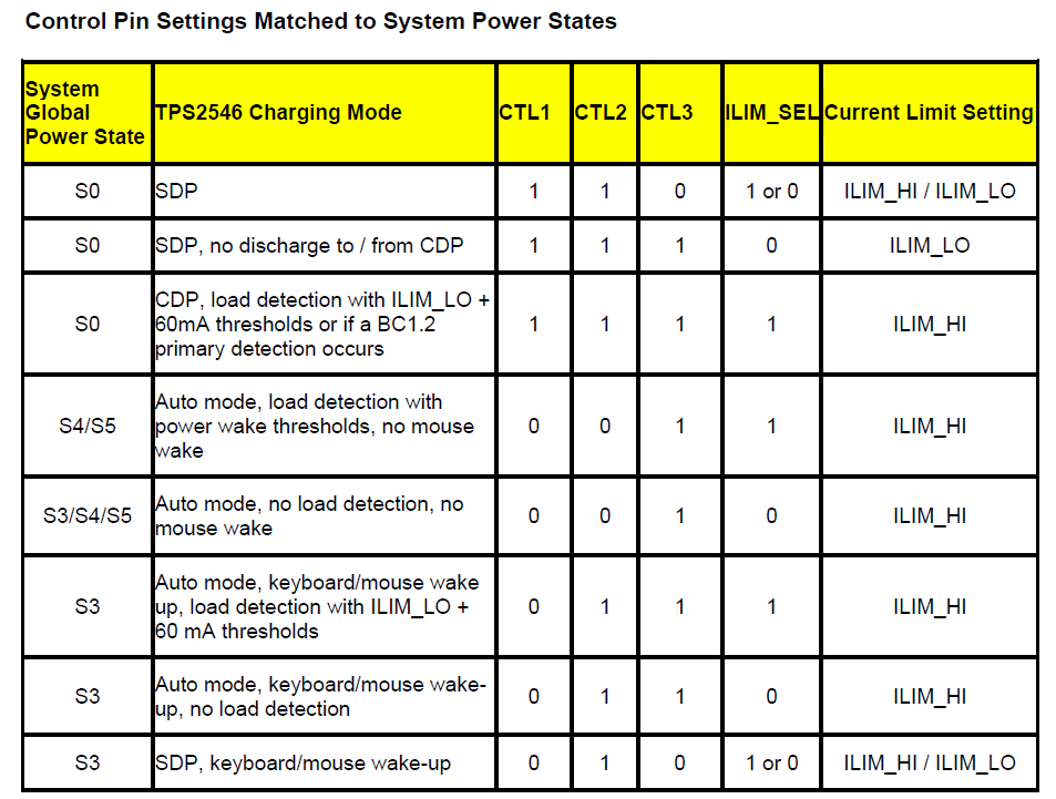

    If follow  TPS2546 SPEC table
    Do you know how to do control pin settings matched ?
    Table 2 will help you match the system global power states and there is not necessarily a difference to having w/ device and w/o the device so you can take that out of the table.
