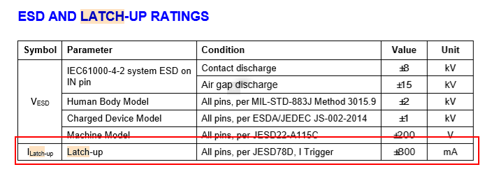

TPS7A05: Lach up information for TPS7A0518PDQNR?
Part Number: TPS7A05
Dear,
Do we have below latch up information for  TPS7A0518PDQNR? Thanks.
