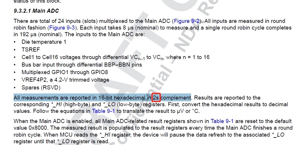

Hi Expert,
BQ79616-Q1 was used on customer side. But there is a data need confirm:
For main ADC, each input takes 8 us to measure, total time is 192us. But in the below description, it mention that all the test need 2s to complete. Do it mean temperature and voltage measurement need take around 1.8s to complete? Could you check it for us? Thanks.
