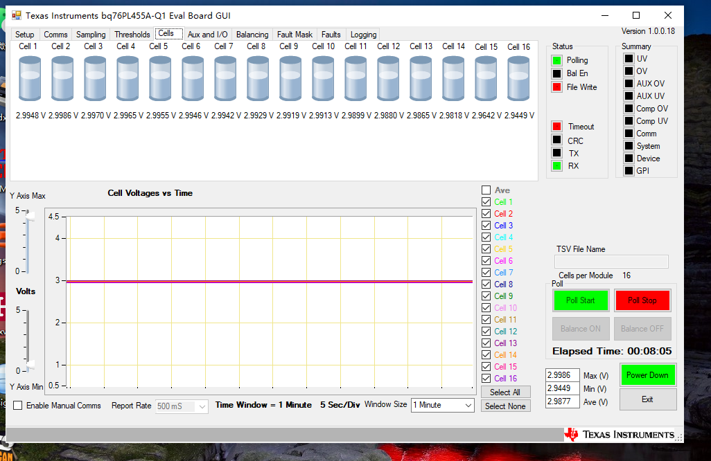

As described in title, here is the screenshot from GUI. could you please tell me what's the possible cause? thanks
Hi Yuan,
Please provide more details to be able to help you on this:
You can double check the setting of the CTO (communication timeout) register (address 40 or 0x28). If the device doesn't receive any valid communication frames during the communication timeout specified in this register, the device will flag a timeout and eventually shutdown. See details in the datasheet section "7.6.3.19 CTO 0x28 (40) Communication Timeout". You can disable these timeouts by writing 0x00 to this register.
