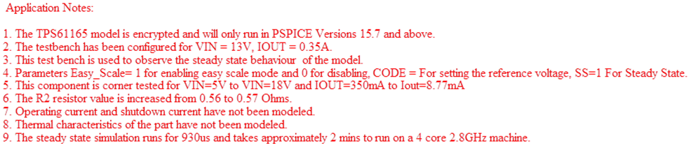

    Please inform me about these points:
    1. Does not TPS61165 model support thermal analysis?
    What I see it when I open the boost reference design:
    "operating current and shuthdown current have not been modeled"
    "Thermal characteristics of the part have not been modelled"
    Without them it is not possible to do correct simulation process.

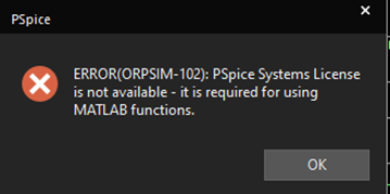

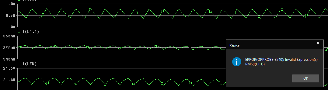

    1. It is not possible to measure RMS on given signals?
    I don’t find RMS measuring. When I want to use RMS() function then I get error.
     "Invalid expressoin RMS(I(L1:1))"
    When I want to use an external MATLAB function, then I get this warning message: „This license does not enable to using MATLAB functions”
    "PSpice System License is not available - it is required for using MATLAB function"
    I don't have any ideas, that I could calculate the RMS values in this simulation.

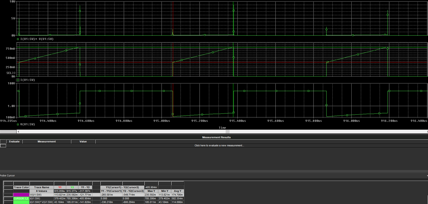

    I can plot U*I functions, but I can not determine the rms of these signals. e.g. P=I(U1:SW)*V(U1:SW). The consuction loss of IC and the swithing loss of IC together give the main part of U1 dissipation power.
    FYI: my target is the calculate the power efficiency, the dissipation power of IC, L and D, and predict the thermal temperature of these parts in SEPIC topology. We could appreciate any help to find the suitable way.

  • Hi Attila,
    Sorry, this model doesn't support thermal simulation.
    You can use PSpice official version for further analysis.
    BR,
