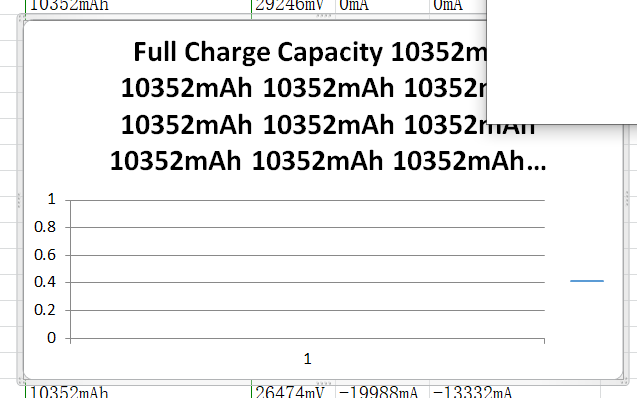

Hello, I found that True FCC becomes smaller,Attach the log(20A load discharge), please see what is wrong.
No. 3 20A discharge.xls
    The log I am unable to graph anything in excel.. Can you fix this?
  • Hi Nick,
    If you enable editing you should be able to graph the log file in excel.
    I was able to and I see what this user is talking about.

  • In my version of excel this all I see:
  • Hi User,
    I have opened a lot of customer logs, never had this problem.
    We also need the .gg and details on the battery.

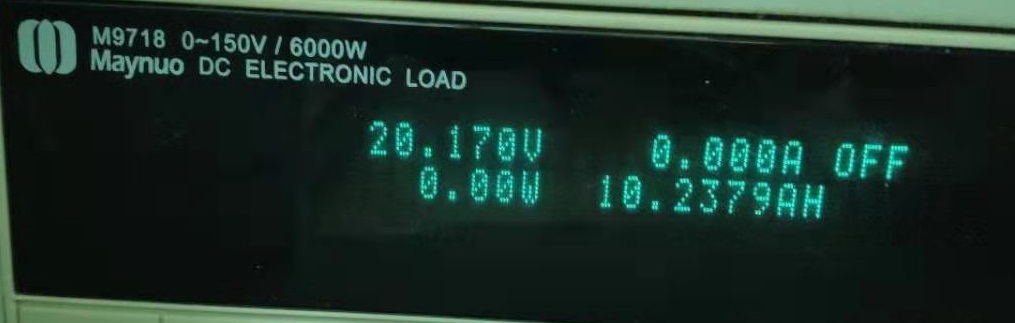

    The actual capacity that can be released is much larger than True FCC, which seems to have the problem of inaccurate battery capacity. Can this problem be solved? If this problem cannot be solved, I cannot proceed to the next step.
    Can you upload a log of the battery discharging from full to empty at 20A? What is the passed charge?
    The passed charge is DOD0 Passed Q.
    20A.xlsx
  • The passing capacity recorded on the electronic load is 10237mAh.
    After the SOC reaches 4%, it drops very slowly, which is not normal. It takes 5 minutes to drop to 0%, which accounts for one-sixth of the total discharge time.

    Here is a gg file running the learning cycle and a gg file exported from the official firmware.
    1588.learning cycle.csv
    bq34z100G1FirmwareBundle-0.16.gg.csv
    How is it going now? I re-learned a used battery (the capacity seems to be attenuated). Modify the scale of 2.After the 20A discharge and let it stand, the updated capacity is a bit larger than before, about 9500mAh. This is the log file.
