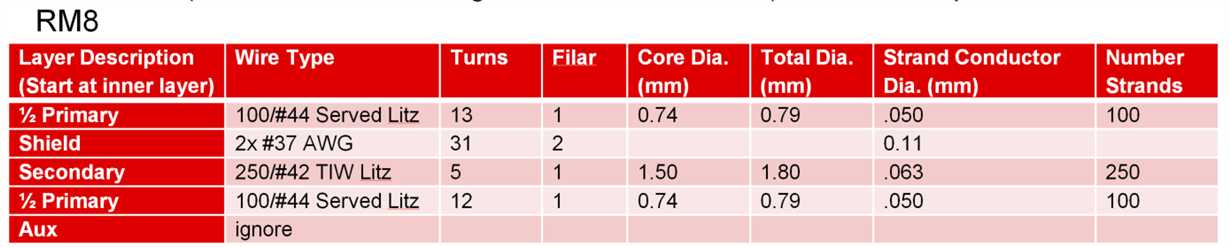

In this user’s guide SLUUBZ3B, I can’t find the structure of transformer. Could you share the T1 RLTI-1349 structure design? Thanks
BR, Gary
BR, Gary
Hi Gary,
EVM board transformer structure shown as below :
Outer layer primary Npri_outer=12T, Ns=5T, Nsec. aux=5T not shown in below image. Npri_inner=13T, CM balance =31T not shown in user guide.
Thanks.
Hi Jaden,
Do you have structure design base on the RM8, and include wire dimension, layers for witch winding? If have one page picture are preferred.
BR, Gary
