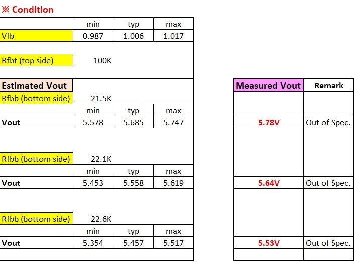

Our customer have an issue that Vout is out of spec.
If you see below table, their measured value was over of maximum spec.
We have debugged like below. But result is same.
-. Changed L1, C34.
   L1 : 6.8uH. C34 : 47pF
   L1 : 6.8uH. C34 : 4.7pF
   L1 : 6.8uH. C34 : Open
   L1 : 8.2uH. C34 : Open
   L1 : 8.2uH. C34 : 4.7pF
If you know the root cause or debugging point, pls let me know the solution.
Here is measured value and schematic.
* Measured value
* Schematic
