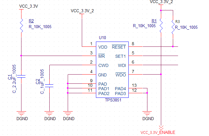

I couldn't attach the waveform, but /MR is High, /REST is also High, and SET1 is kept high for about 1-2 seconds, then becomes LOW, and WDI is switching to 3.3V voltage every 1 second. At this time, /WDO is kept high.
The circuit is roughly as follows.
Thank you.

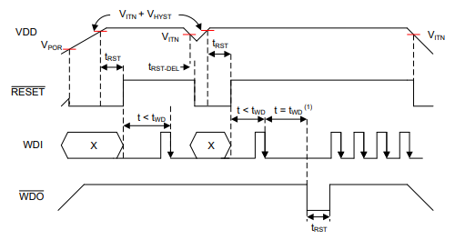

  • /WDO output high is normal (no fault) condition. /WDO low is fault (timer expired) condition (figures 1 & 2 in the datasheet). SET1 going from disable to enable has a startup window during which there will be no response to WDI transitions (Fig.23). Depending on which orderable is used (S or E in the name), for example TPS3851G33SDRBR vs TPS3851G33EDRBR, 1uF capacitor on CWD results in timeout of about 3.3seconds or 77seconds (Table 4 and Table 5)- is that the design intent?

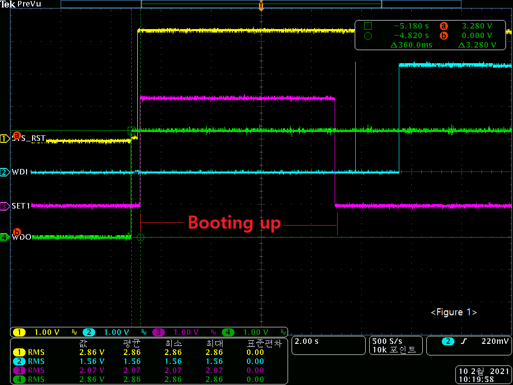

    As shown in Figure 1, during initial booting, SET1 is in high state for about 8 seconds, and then asserts to low.

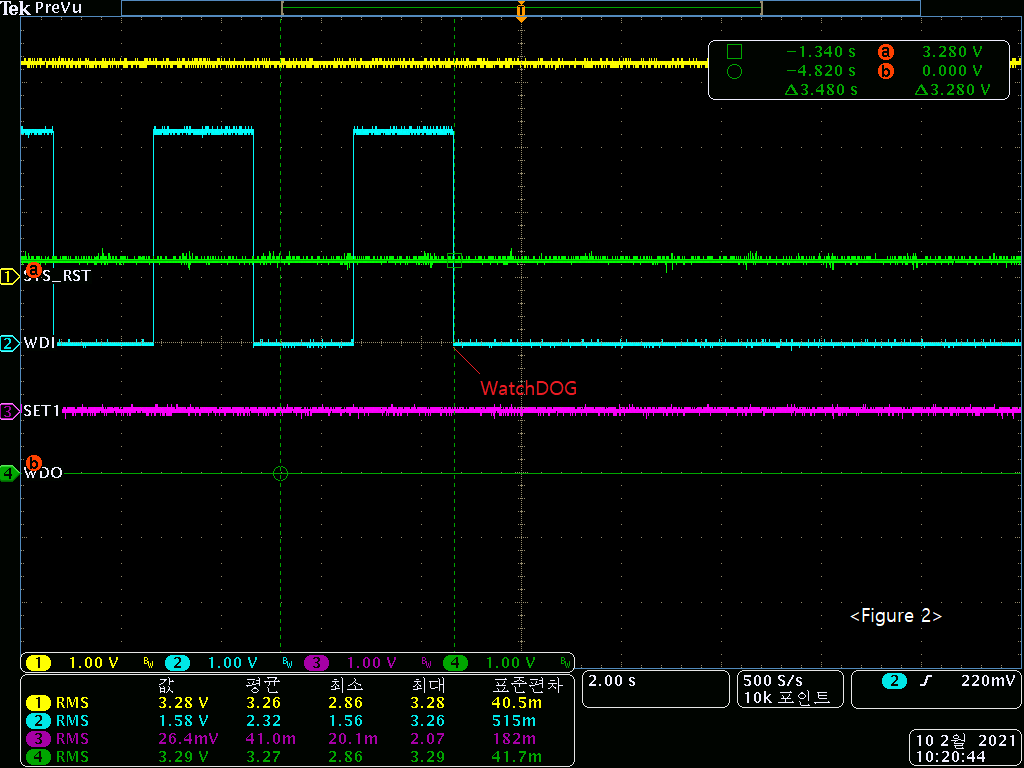

    After that, after booting is complete, the WDI pulses every 2 seconds and as a result, /WDO=3.3V is output.
    Here, I want to ask you a question.
    As a result, SET1 is asserted as Low, but /WDO is output as High.
    Could it be that SET1 high output for several seconds during initial booting, could be the cause of making /WDO high??

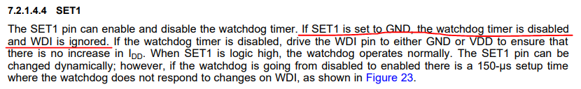

    Please see my answer in red below:
    When SET1 is asserted low, the watchdog timer is disabled and /WDO becomes high-Z state.
    No, /WDO is high because the SET1 pin is pulled low.  When SET1 is pulled low, any input to the WDI pin is ignored.
    If so, can you elaborate on why?
    /WDO stays high when /RESET is low and /WDO will stay high unless it does not sense a falling edge of WDI within the timeout period (twd) for SET1=high.  See below:
