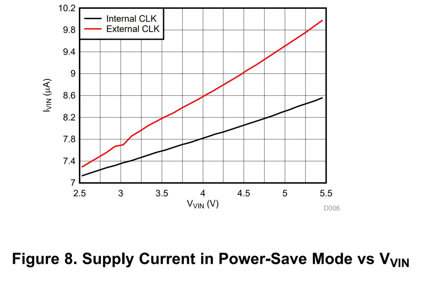

Hi there,
When going through the LP5569 datasheet, I read at 8.5.2.3 that "Using an external clock enables synchronization of LED timing to the external clock signal and is also more power-efficient".
However, I couldn't understand how much more efficient it is to use external CLK, and some data (shown below) leads me to believe that internal CLK is equally or more efficient then external CLK.
I'd like to better understand the advantages of using external CLK in order to decide whether or not to use it in my custom pcbs. Is it more power efficient? If yes, in what case(s)?
Thanks in advance for your support,
Bruno

    Please refer to the 8.4 chapter on the datasheet of LP5569, which describe the various modes of operation. The table you marked shows IVIN under different operation modes and during standby/power-save mode there is no current in the LED OUTx pins, so no different between external clock running and internal oscillator. figure 8 also shows the different under power-save mode.
    The advantage of external clock will be reflected in normal mode.

  • Hi Mauricio,
    Sorry for late reply. Monet is out of office and I will help to answer your question. Here is some current consumption value I tested in EVM board. It includes consumption for on-board LDO so the value is larger than datasheet. The consumption would increase around 0.28mA with external clk signal.
    This 32kHz signal is the execution clock for engine codes. As we know there are some variation for internal oscillator frequency of different units, due to manufacture process. When there are multi LP5569 using internal engine to perform animation, they may have some difference after running long time due to the different execution clock. So with the same external clock source, they can display animation totally synchronized.
    Iin / mA no external CLK with external CLK
    EN on; Chip_en = 0 0.0279 0.302
    EN on; Chip_en = 1 0.269 0.542
    one channel PWM = 0xFF 17.589 17.861
    all channels PWM = 0xFF 215.57 215.84

    So the conclusion is that using internal clock consumes less power than external clock. Is this right?
    Thanks!
  • Hi Bruno,
    Yes. Using internal clock could save some power, comparing with external clock.
