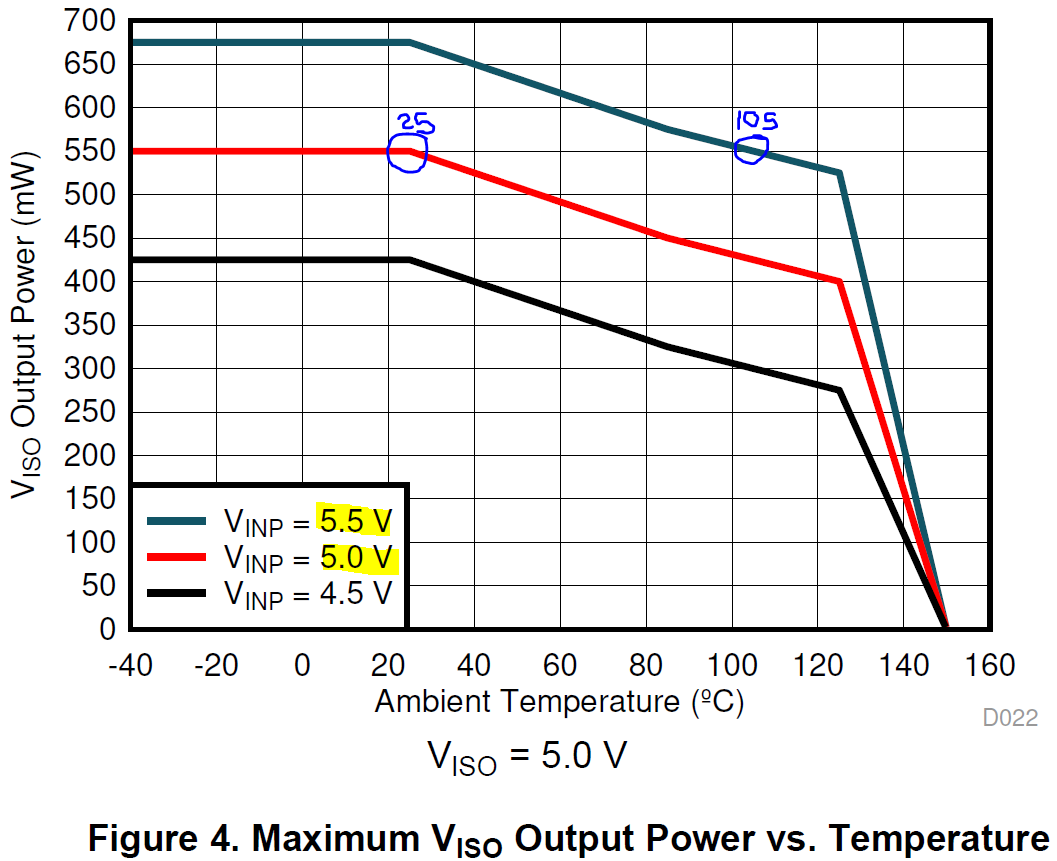

My customer is considering using UCC12050.
They would like to know if UCC12050 can output 550mW surely.
However, I can not find specifications regarding output power.
Is the maximum output power guaranteed?
Kuramochi
  • Hi Kuramochi,
    Section 6.12, pages 10-11 of the UC12050 data sheet show our temperature derating curves for all VISO output voltage settings and the range of allowable input voltage, VINP. One example for VISO-5V is shown below. You can see that if 550 mW is required, this is only possible for -40 C<T<25 C when VINP=5 V or -40 C<T<105 C for VINP=5.5 V. Thanks for connecting through E2E.

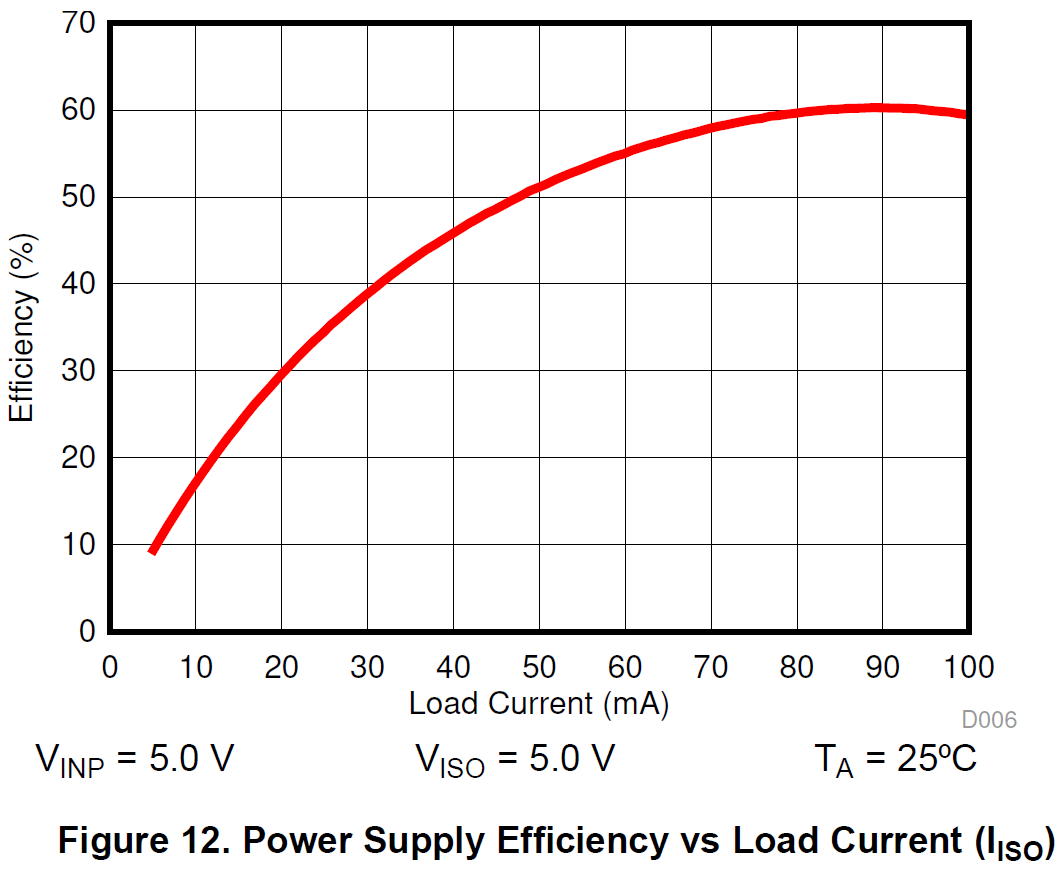

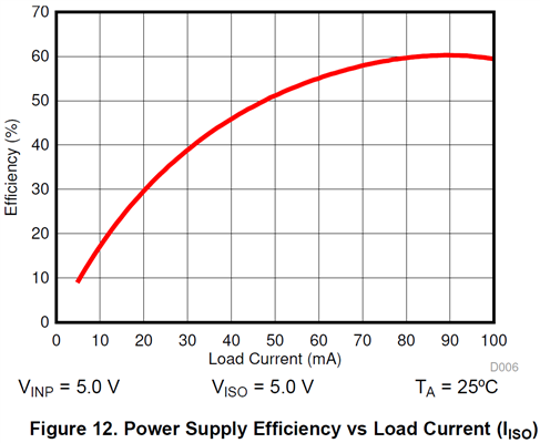

    From my previous response, for VINP=VISO=5 V, TAMB=25 C, PISO=550 mW. The efficiency curves given in the UCC12050 data sheet only show nominal values such as VINP=VISO=5 V, TAMB=25 C, PISO=500 mW. From the curve below, it seems the efficiecny over one additional division would mainatin 60% at IISO=110 mA (550 mW case):
    Calculate the total input power as:
    PIN=PISO/0.6=550 mW/0.6=917 mW~920 mW
    Calculate the UCC12050 power dissipations as:
    PDISS=PIN-PISO=920 mW-550 mW=370 mW
    Junction-to-ambient and junction-to-case, thermal impedance from the UCC12050 data sheet:
    RJA=57.5 C/W
    RJC=21.4 C/W
    Calculate estimated junction temperature at TAMB=25 C:
    TJ=[RJA*PDISS]+TAMB=(57.5 C/W*370 mW)+25 C=46.275 C
    Calculate estimated case temperature:
    TC=TJ-(RJC*PDISS)=46.275 C-(21.6 C/W*370 mW)=38.3 C

  • Kuramochi
    For the parameters you provided, VINP=VISO=5 V,  T=25 C, you can expect 550 mW of output power as the worst case. This is according to what TI has committed to from the data sheet curves I’ve used in my calculations. The data sheet temperature curves are taking process and tolerance into  consideration. TI also applies some guard band limits to assure manufacturability but these limits are not shown in the data sheet. We don’t want customers designing beyond the power and temperature derating guidance provided in the data sheet.  I hope the analysis I’ve provided helps  assure you of the advanced process, packaging and integration capabilities of  this exciting technology. Thanks for connecting with us through E2E.
