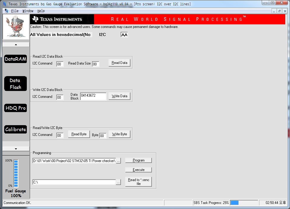

I have bq34z110 and EV2300. When I read data flash, I can see this error " Error reading data flash subclass IT Cfg, code = 772 ".
How to solve this problem?

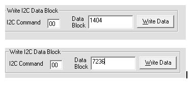

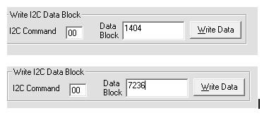

The process to unseal the device is in the EVM User's Guide. Here is an excerpt.
Ensure that the gauge is in Full Access mode. The SS and FAS flags in the Control Status register
must both be unasserted (Green). If not, use the appropriate data block codes to command (0x00) to
clear the flags. Default codes of 0414,3672 to unseal and ffff, ffff for full access can be typed into I2C
Write Block feature, or into the value field of the control register on the Data Ram screen followed by
Enter. Scanning should be halted during this operation to insure the words are received consecutively.
