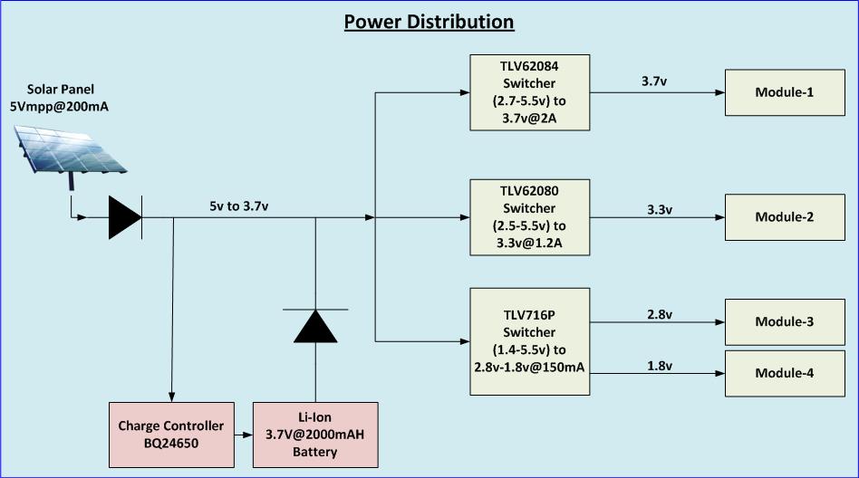

    We want to clarify above post our system load is 190mAh/day.it is summation of active mode and sleep mode current require in one day. If we calculate required current in one hour is 3.7@8mAh (190mAh/24). Here battery have rating of 3.7V@2000mAh . So, it provides battery backup for 10 days    ( 10days*190mAh=1900mAh)
    Our system working in two mode.
    1. Active mode require 3.7V@1.9mAh but peak is 2A for 5 sec in one hour
    2. Sleep mode require 3.7V@5.5mAh
    Below, Saw power distribution block diagram of our system.
    We have explored BQ24650 acherge controller but we have few queries as mentioned below.
    1. We think that max voltage of Li-Ion battery 4.2V so we set Vfb is 2.1v and BQ24650 always sense this voltage of VFB pin and compare with threshold 2.05V. So Charging will remain off till Vfb pin between 2.1v to 2.05v.It means battery voltage goes below 4.1V than again charge battery.
    2. Here diode mechanism is used for switching. If system load will work on battery backup than diode will be conducted. As per our block diagram, module 1 is working on 3.7V. So, battery will provide 4.2 - 0.5 (diode forward voltage) = 3.7V.
    Does our understanding is correct.
  • Hiren,
    1. Yes you are correct about how the recharging works.
    2. Yes I understand your diagram and makes sense. However, for Module 1, you need to have a larger gap between 3.7V and the battery voltage. The lowest dropout for the switcher at 2A is (VIN-VOUT)=(~240mV + (inductor DCR * 2)), so a fair estimate would be ~300mV. You would need ~4V input on the switcher for it to supply 3.7V output.
