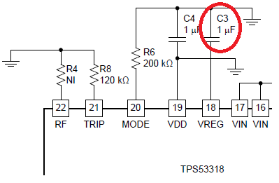

Is there way of long delay tyme for TPS53318's UVLO?
I think that VREG~GND capacitor change large value, UVLO response time will slowly. (please see below)
Is is correct?
If correct, is there any risk?
【Background】
・LM3880 sequencing TPS53318
・When occur the momentary power failure(1ms), TPS53318 is UVLO-shutdown(VREG), but LM3880 is keep on moving.
  As a countermeasure, I want to adjust TPS53318's UVLO delay time.
  If TPS53318's UVLO response can be slowly, also LM3880 and TPS53318 keep on move when 1ms-voltage drop.
Satoshi
  • The output source of VREG5 is an internal LDO. The output capacitor is chosen for stability. You might be able to increase it slightly. It would be best to have an external voltage monitor and reset to cycle both TPS53318 and LM3880 in the event of a power loss. 1 msec is a long time.
