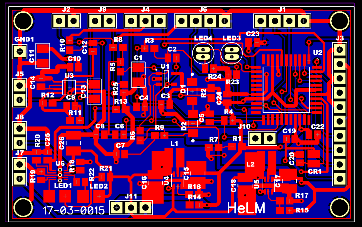

I use 2 of these on a board, one for 5.0V, and the other for 3.3V. I set the resistors appropriately. 3 boards were built up, and the supplies tested. Out of 6 parts, one gave me the correct voltage - 5V, and the other 5 were all over the place. The one correct part regulated reasonably well, the other were far from spec. The 5 "off" parts had the FB pin ranging from about 0.22V to 0.98V - not the 0.5V as per the data sheet.
The layouts are reasonably close to the suggested layout. Both input and output  caps are 10uF. The resistor selection was per that suggested in the data sheet.
Can anyone tell me why these parts fail so miserably? I cannot see anything that I've done that is in great variance with the Datasheet.

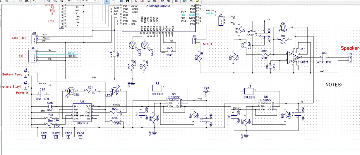

  • Can you post your schematics? What is tour input voltage? What type of output current do you need? The maximum output current is dependent on the input voltage.
  • HI John:
    The schematic is that shown in the data sheet. Values were determined by the TI design program. I set the input from .9 - 1.5 [actually will be a single cell Ni-MH. I use two if them, one for 3.3V and one for 5V. My current will be under 30 mils for each, but for design purposes, I used 50 mils. I directly connect the EN pin to Vin, slightly different from the suggested layout.

    improper layout could cause this problem. could you share the image of the layout of TPS61220? please also share the schematic and part number of the inductor.

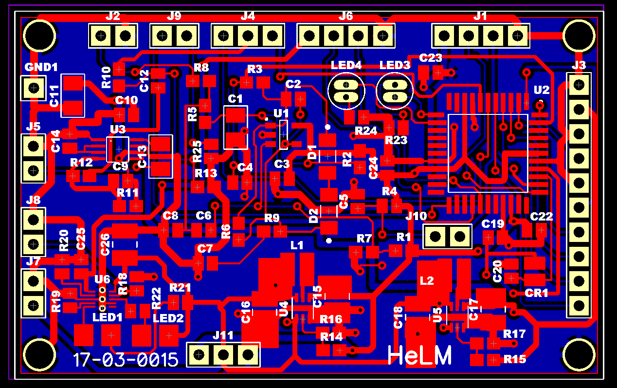

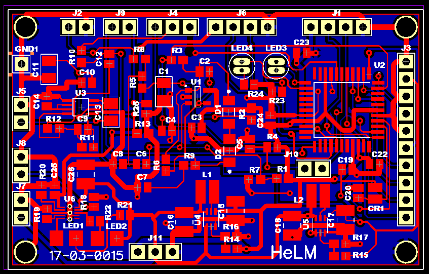

  • Here is the schematic [the third image]  [the relevant part], plus two board files. "current board" [the first image] is the board I am working with, and having trouble with. The "reworked board" has been modified to more closely resemble the recommended layout [the second image].
    I am not anxious to have the reworked board fabricated unless I am reasonably sure I am dealing with a layout problem, and not something else. If it is a layout issue, I then presume that this is a parasitic inductance problem with the leads?
  • I should mention, the schematic shows the TPS6122. I am actually using the 61220

    Instead of buying the sample board, I redesigned our board so that I was exactly copying the suggested layout per the data sheet. Got the boards in, built up two test boards, and guess what? THEY WORK perfectly!!
    My only comment to anyone using this type device. LAYOUT, LAYOUT, LAYOUT!!! There is a good reason for suggested layouts. Even the tiny inductance of leads can cause problems [at least that it my assumption why they failed with my first design.]
