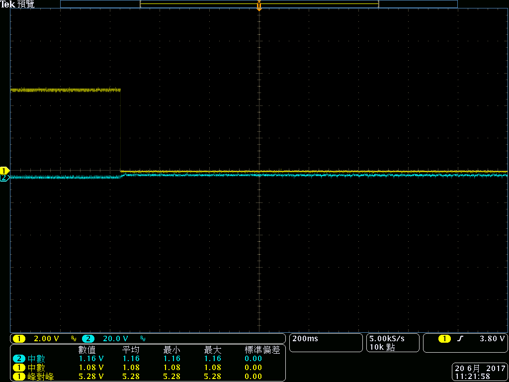

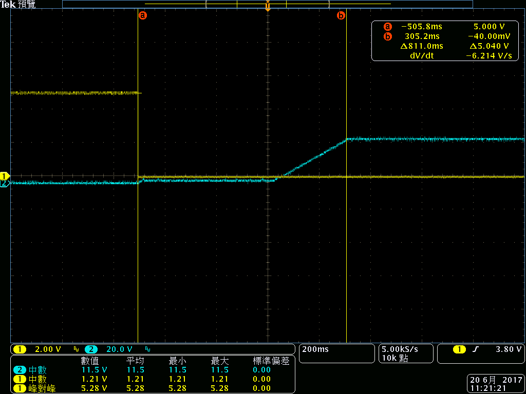

Hi Sir,
May I know TPS25910EVM-088 for inrush current test has limitation? Since we test EVM find some question.
In out  Application 20V VIN, so Limitation 5W /VIN just can pre-load 250mA - 500mA and start up 25910? right?
yellow trace :EN
blue trace 2:Gate
Vin:20V, Cext=0.1uF, pre-load=500mA
yellow trace :EN
blue trace 2:Gate (no response)
Vin:20V, Cext=0.1uF, pre-load=1A
