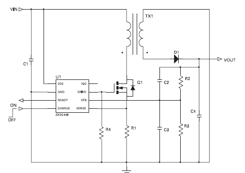

Is it possible to use the TPS6104x in a flyback configuration, similar to this?
We need 60-200V range for APD bias. Load current is <1mA. Output ripple is not a major concern, we can filter higher harmonics with a 2nd stage RC filter.
The transformer would be 1:10 ratio, something like TDK ATB Series.
  • TPS61041 is an integrated boost conveter. Its internal MOSFET VDS voltage is less than 30V, so it is not fit for the application. Suggest you use a controller like LM3478 with external MOSFET to realize the function. But make sure the Vin pin voltage should be less than 40V
