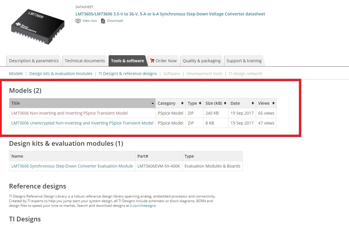

I have Tina as well as LT Spice XVII and I'm trying to figure out how to do a simulation with the LM73606 part.  I've downloaded these files:
1. Should I be able to open one of these files and build a circuit around them in Tina?  I've downloaded Tina to my laptop.
2. What is the difference between the two files?
  • Robbie,
    1. You should be able to download them and import them into TINA but it's a bit of a pain. I'd recommend using WEBENCH to create a design, then export to TINA. That should do most of the work for you in terms of getting this into TINA as well as part selection.
    2. One is encrypted, one is unencrypted. Unencrypted lets you modify certain parameters if that's what you need. Encrypted hides this ability so the model won't get messed with.
