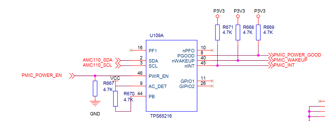

       When using TPS65216 on AMIC110,  we have some below questions need to discuss with you.
  1. Customer don’t use PFI and nPFO, let them NC, is it ok?
  2. Customer don’t need PB function, let it pull up, is it ok?
  3. Customer don’t use AC_DET, let it tie to IN_BIAS(VCC). Is it ok?
  4. The PWR_EN connect to AMIC110 the pin PMIC_POWER_EN,  or let PWR_EN pull up?
Thanks for your help!
    Yes.
    Yes.
    No, if PB is un-used you must short AC_DET to GND.
    You should connect PWR_EN of the TPS65216 to the PMIC_POWER_EN pin of AMIC110.
  • Hi Brian,
    Thanks!
    If AMIC110 don't use RTC, PMIC_POWER_EN pin of AMIC110 would not output high logic to TPS65216.
    So customer want to let PWR_EN of TPS65216 pull up. Do you think it make sense?
    Thanks!
  • Eggsy,
    Yes, the PMIC will operate correctly if PWR_EN (pin 46) is pulled up directly to the main input voltage (VIN or VSYS = 3.6V to 5.5V) through a 100kOhm resistor. This is what we refer to as an "always-on" use case, since the PMIC will not be able to enter any low-power states.
