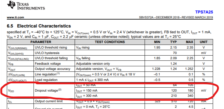

I want to use TPS7A25 for one of my design.
My application requirement is for adjustable voltage output.( Vout = 4V).
I am refering datasheet : SBVS372A –DECEMBER 2018–REVISED MARCH 2019
My question is :
While refering Section 6.5 Electrical Characteristics, which mentions :
specified at TJ = –40°C to + 125°C, VIN = VOUT(nom) + 0.5 V or VIN = 2.4 V (whichever is greater), FB tied to OUT
>> As per my understanding [ VIN = VOUT(nom) + 0.5 V ] this will be applicable to only FIXED OUTPUT type design.
am I correct?
>> As per the formula for adjustable Vout,
VOUT = VFB × (1 + R1 / R2)
In this formula Vout is not at all dependent on Vin.
So do I have to bother about [ VIN = VOUT(nom) + 0.5 V ] condition.
>> For Vout = 4V using adjustable output type configuration, is it possible to provide any VIN within specified VIN range i.e. 2.4V (min) to 18V (max)?
