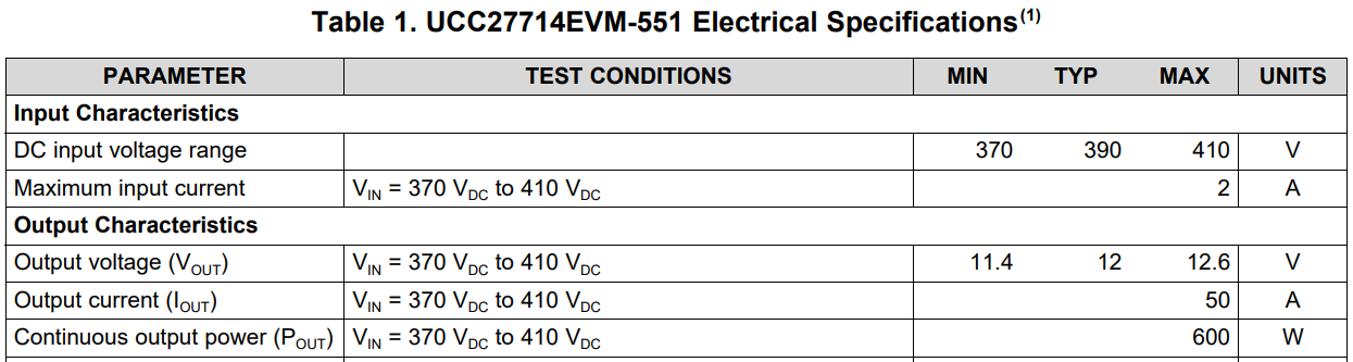

1.Can this EVM output 0.5A@12V?
  I would like to confirm with EVM spec.

    Thank you for the interest in the UCC27714EVM-551. Regarding the question if the EVM can support 0.5A at 12V output, the EVM is rated for output current from 0 to full load current of 50A so this condition is covered.
