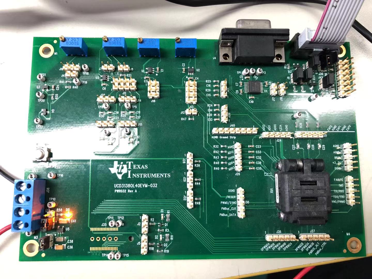

I use the boad of UCD3138OL40EVM-032. I put new UCD3138A in it . Then I pen the GUI of UCD3XXX device GUI. the version is v3.0.30(2018-03-02). I put button of "Scan device in rom" and the log display "Error: unable to communicate with rom".
Then i test the VDD is 3.3V. Also use provided jmper jump across J39. The led of EVM is lighted on. I also change the UCD3138A to UCD3138. what can i do next?

  • Hi, Yitzhak Bolurian:
    I have tested BP18 Pin and Ground . it is 1.8V.
    I also remove the jumper(J39) and chang the voltage supple from USB port to extern 3.3V.
    The issue don't solve.
    You can see the picture. I add jumper J6,J9,j10,J42,J33,j34. Is it OK?
    Thank you very much!
  • How many mA does the board drive from your power supply? Please advise.
    Please also take a look at the following user guide that includes the schematic of the board.
    https://www.ti.com/lit/ug/sluua80/sluua80.pdf
    I could see from the picture that you have attached that supply voltage is connected to pins 1 and 4 of the screw terminal.
    The best option is to connect 3.3 to pin 2 or 5V to pin 3 (Pin 1 is GND).
    If add the jumper of j39, the current is 82mA. if not, the current is 68mA.
    I have seen the use guide.  After read it, i add the jumper of J6,J9,j10,J42,J33,j34.
    I try to give the board supply with extern dc soure for 3.3V or 5v. But the issue do not solve.
