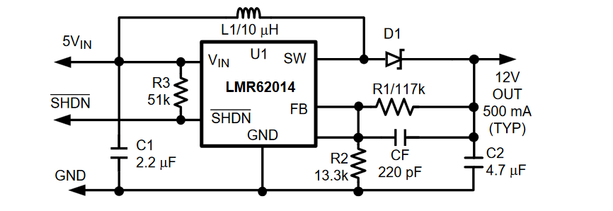

Hi all
This is Sudharshan
I m using LMR62014 for 5V To 9V boost conversion .Load current is 500mA
I used the same application circuit given in datasheet .
Input is 5V , But o/p is oscillating between 9V- 12V ,Not proper o/p expected .I monitored the output pin in scope it seems like pulse waveform
I need a clarity on this ,since i followed all recommendations kept the o/p capacitors close to output .The IC is assembled with external components  on a General purpose PCB
Kindly guide me to resolve this use
