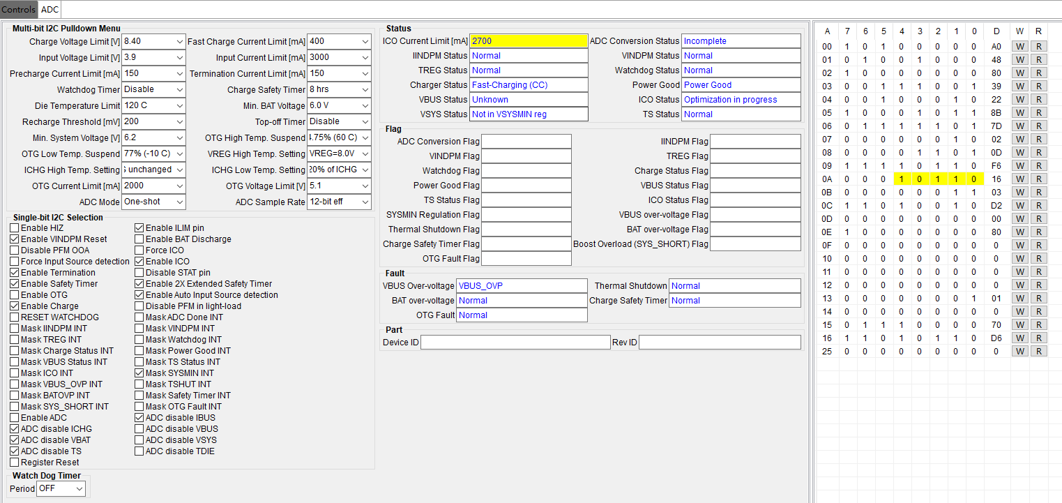

  • Dear Michael,
    I'm his customer,and I asked the question.The I2C resister is shown in the figure below.
    Maybe I have written the IINDPM setting 500mA,  either the ICO or the ILIM pin could be limiting the current still.So the charging current is 420mA is Relatively reasonable value.
    Thanks.

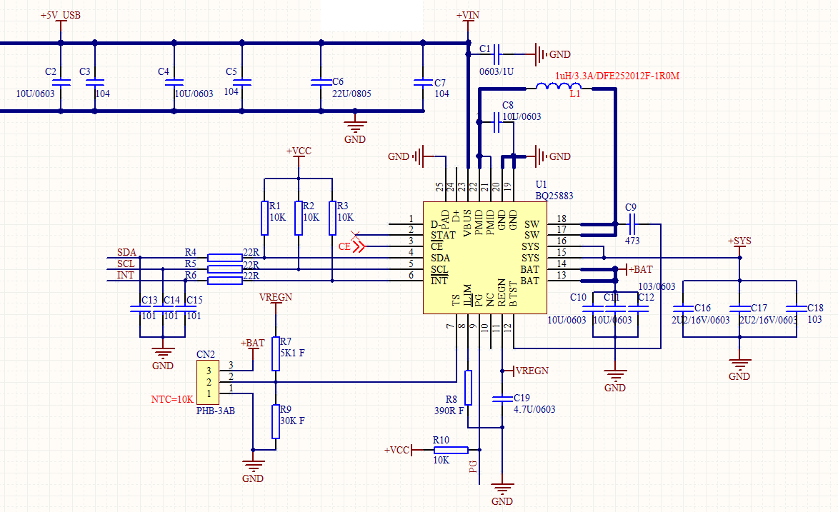

  • Can you provide all the registers, including the flags? I need to see if the ICO is even triggered. I think that you may be limited by your ILIM pin right now. How is the ILIM pin connected on your schematic?

  • Dear Michael,
    All the registersand my schematic are shown as the figure below,
    Thanks.
  • I think the problem here is that the fast charge current is set at 400 mA. What happens if you increase the fast charge current register?

  • I have increased the fast charge current register.It seems to work. bq25883 connects to MCU.But unpluging the adapter and pluging it in again to charge the device, the charging current is pulled down to a fixed value. For example, when I set 500mA(or a higher value), the actual current is only about 300mA.Will bq25883 change charging current after power on reset?
