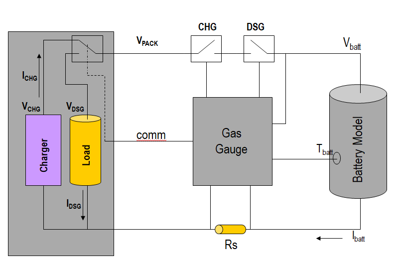

    I need some clarification about how to use this IC together with the BQ25601D, I've attached an hypothesis the doubt is how to perform the ground connection between this two IC.
    The charger need to see the battery, so from this perspective this should be put on the battery ground side, but making this leave Rsense out of the load loop so no battery current measurement will done by the gauge IC, on the other hand if the BQ25601D ground will put at the PACK- side, the battery is not directly connected between the BAT pin of the BQ25601D and the related ground because between this two ground points we have the shunt resistor Rsense that may have some influence or not, I really do not know, on the BQ25601D charging algorithm, ... I'm missing somethings?

  • Here is the basic smart battery circuit.  From a gauge's perspective, the BQ25601D ground should be put at the PACK- side.
  • Hi Andy,
    thank for your time.
    This solution is as into my conceptual schematic, in this one the ground of the charger (BQ25601D) is not directly connected to the battery negative pole so the charger have also the shunt resistor inside the loop with the battery, the question is if this type of connection, due to the presence of the shunt resistor, can make trouble  to the charger algorithm or not, I really do not know what can be the behavior of a such system setup. Do you have tested it in practice or just a your think as mine?
    I know that I may seem persistent, but having to make printed circuit boards I have to be reasonably certain that the system is able to work properly.
    Also in your schematic I can see the comm connection between the gauge IC and a SPDT switch to perform charge/discharge of the battery, by working with the BQ25601D I think that this is not used because the charger make itself all the needed work to charge the battery, I'm right?

  • No. I don't think that will make any trouble.
    Let me find a better block diagram for you.  Take a look at the BQ27531-G1 datasheet. On its first page, you will see a simplified schematic which includes a charger and also a gauge device.  Check the GND connections.
