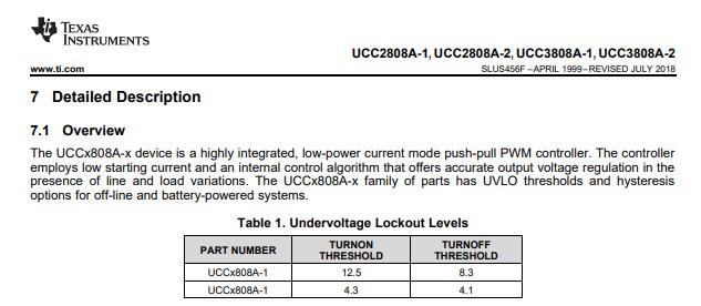

Dear TI
I think ucc2808a pdf has a wrong information in table 1.
Second line , UCCx808A-1 --> UCCx808A-2??

Hi Choi,
Thanks for bringing this to our attention.
The last line in the table should be UCC2808A-2.
We will add this to the documentation queue to update the datasheet.
