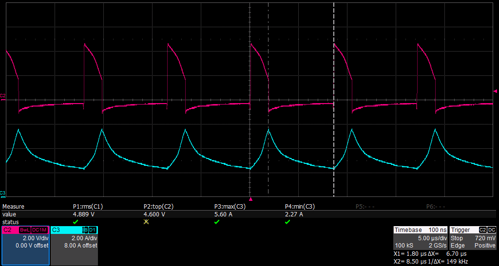

I got a problem with LM5160-Q1.
First, the current limit is 2.5A typ. When Vin is more then 6v. The operation is normal. The Isw reach 2.5A , IC operation at short circuit mode.
But , when Vin equal 5v, the current limit  become about 5.2A.
The input current become very high. Can you explain it? Thanks.
 Spec. and The waveform below
Fly-buck topology
CH2: Vsw  CH3: Isw

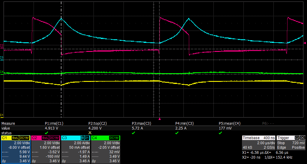

    So, when input voltage equal 5V. The waveform below
    CH1 : Vin   CH2 : Vsw    CH3 : IL     CH4 : Vo

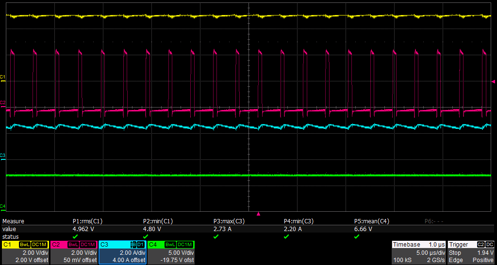

    When Input voltage equal 9V
    We can see that, when input voltage = 5v, IL reach 2.5A , the duty doesn't turn off until the current reach 5.72A
    And I did one more experiment, take another power source set 6V and connect to Vcc pin.
    Vin  = 5v, the OCP function work normally. The IL reach 2.5A ,the duty turn off immediately.
    Thanks.

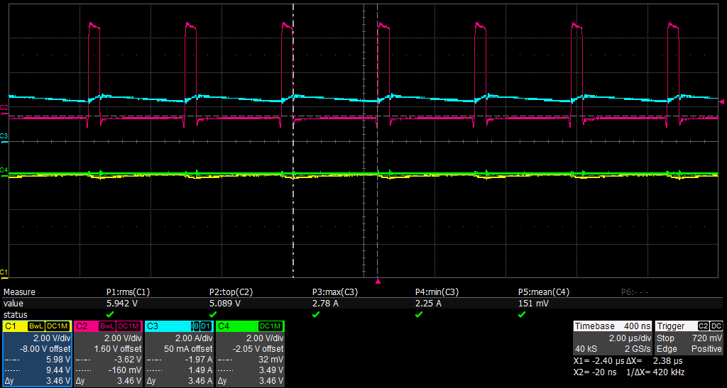

  • Hi Iven :
    Because of the large current, the Vsw is abnormal.
    In normal satiation , when IL peak reach 2.5A(typ), the high side mos turn off immediately.
    But, in1st pic , IL peak until it reaches 5.72A , high side mos turn off.
    It's that OCP didn't active when Vin = 5V in my circuit.
    Thanks.

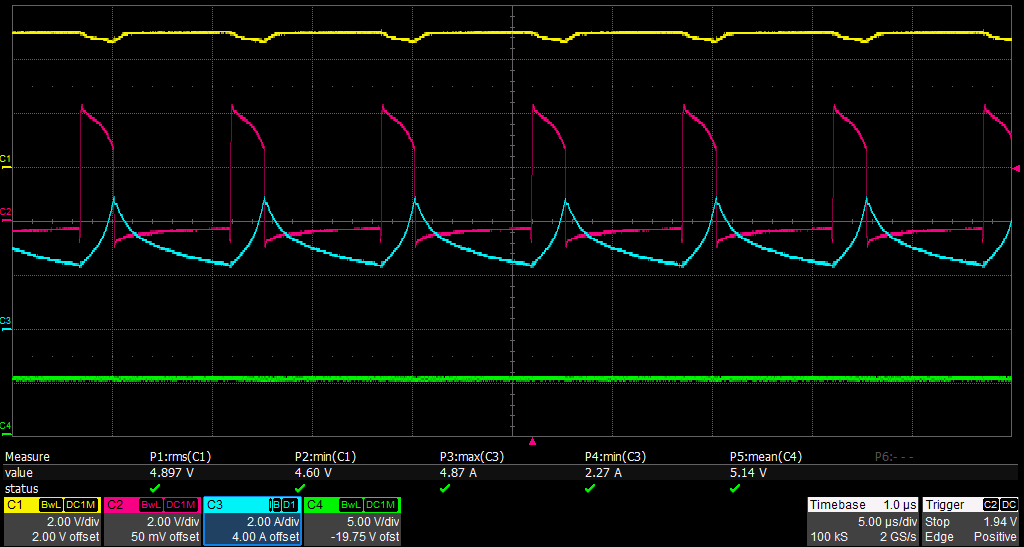

  • Hi Iven:
    At the beginning, I doubted the Vin drop under the uvlo of IC(3.98V typ).
    So I added two more 47uF CAP at input.
    Here is the waveform.
    CH1 : Vin  CH2 : Vsw  CH3 : IL   CH4 : Vcc
    Obviously, the Vin min is 4.6V. It's far away from 3.98V.
    Mentioned before,I provided a 6.5V to Vcc pin
    We can see that when IL peak current reach 2.73A, the high side mos turn off immediately.
    The different of those experiment is the value of Vcc.
    First one, Vcc is regulated by internal regulator. when input voltage is 5V. Vcc is 5V - VCC(LDO). Maybe 4.8V.
    The second  experiment, Connected a  7V power source to Vcc. It passed by  the diodes , must deduct the Vf.  So , the value is 6.6V.
    So , I wonder why Vcc voltage effect the OCP function active or not.
    And , How did the Mos trun off at first experiment. What condition to turn off the mos at 5.72A.
    Thank you so much.

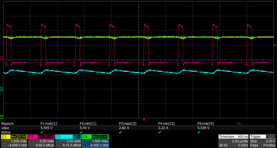

  • Hi  Iven
    At normal operation mode.
    Input voltage and Vcc voltage measured are 5.47v and 5.45V.
    So, the Vcc voltage is normal.
    And, the waveform below.
    Vin is 5.516V and Vcc is 5.463V without external voltage sourced.
    Vin is 5.545V and Vcc is 5.539V with external voltage sourced.
    I think 5.5V is the boundary of whether OCP acting normally or not.
