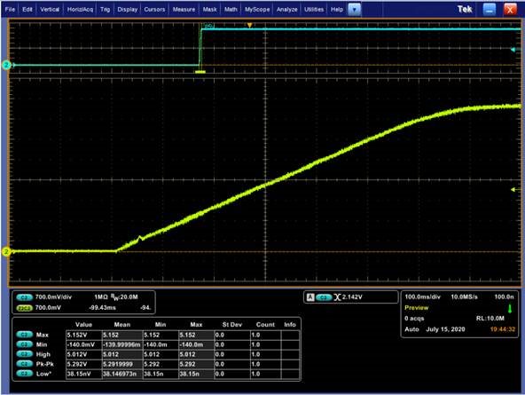

Hi team,
we find the TPS548D22 start up waveform isn't monotonous. We want to check the reason. In my opinion, it's because the soft start and FB are not tracking well during the startup period. So increase the SS time should be helpful. Could you please help share some comments? Thanks.

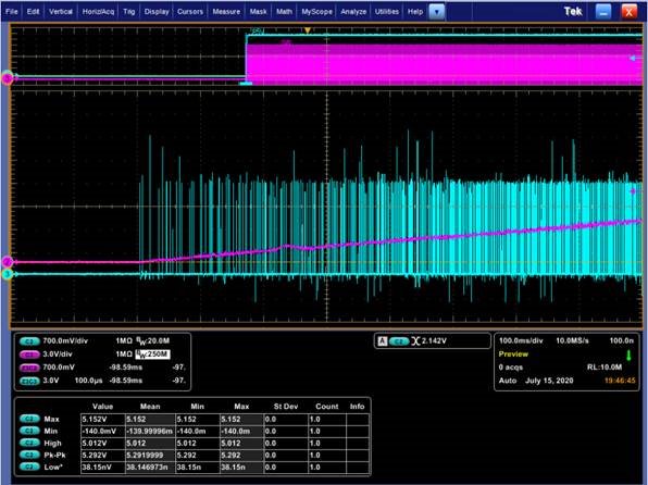

  • Looks like ss ramp up faster at the beginning, FB does not follow well, but that should not cause problem as my mind, I will forward expert for this part to review.

    The TPS548D22 soft-starts in auto-skip mode, even when programmed for Forced Continuous Conduction.  The fact that the converter is still switching while the output voltage is decreasing indicates that there is some loading on the output through this transition.  It is possible that the converter reached some load compliance voltage where the loading characteristics changed, and the converter over-shot the soft-start ramp during its recovery, much like regulated output responding to a load transient.
    Is this from a customers board or our evaluation module?
    What was loading the output during the test?
    Most electronic loads, for example, have a load-compliance voltage, an input voltage to the load where they can begin drawing and regulating current.  Below that input voltage, they can't draw much current.  That causes the load profile to impose a transient on the supply voltage as it ramps up.
    If this is with no load, or with a resistive load, it could be a lag in the tracking of the rising reference voltage, followed by a small overshoot and recovery before tracking the reference, but the characteristics look more like a dynamic loading response.

    The test is with the customer's board. No additional load when do the test, and the drop voltage point is only 90mv. So the load will have no change for the CPU is still off with that voltage. Thanks.

         If the converter puts out a minimum on-time during the initial portion of the ramp up, this will cause the Vout to overshoot slightly before the on-time catches up. Can you try reducing the softstart time? This will put a higher demand on the on-time pulse and should either cause the drop voltage point to become lower than 90mV or go away completely.
