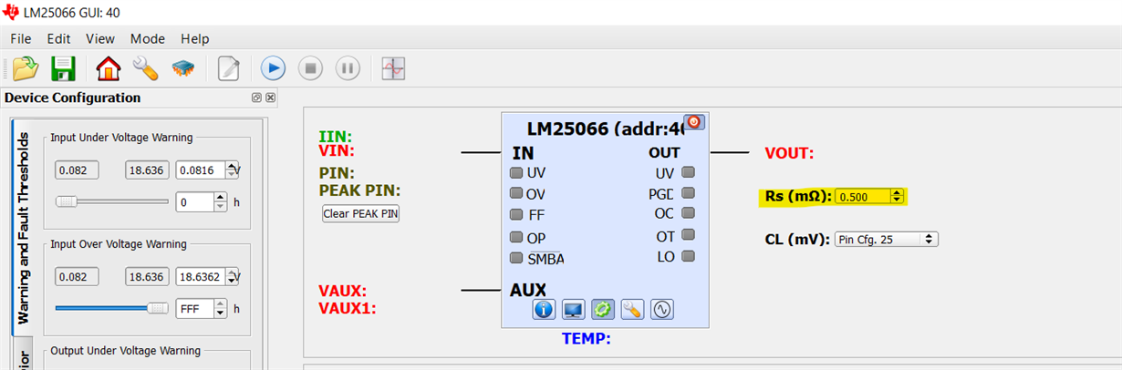

    Can you please confirm which software you are using to communicate with LM25066 ?
    PI-Commander EVM GUI is the recommended software to be used for  TI Hotswaps.
    In PI- commander, you will have an option to set the Rsense resistor that you have used on your board as shown below.

    I uploaded the PNG file at attached.
    And the IIN reporting result is stiil not linear, as below test table.

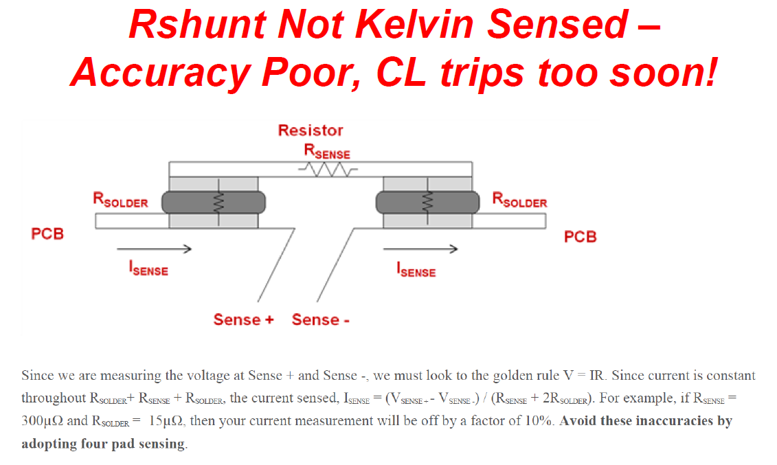

     There are three reasons for current sensing errors in LM25066,
    1. Offset error of the internal current sense amplifier. For LM25066, the offset voltage can be around 4mV (including margin). This will result in poor accuracy at lower currents and the accuracy degrades with lower shunt resistor values.
    2. Rshunt Not Kelvin Sensed. Proper kelvin connections are needed to avoid errors in sensing.
    3. The current flowing through VIN can be 8mA. If the Sense+ trace is long, there would be voltage drop on this trace (8mA x Trace resistance) which will cause offset error to your current sense measurement.
