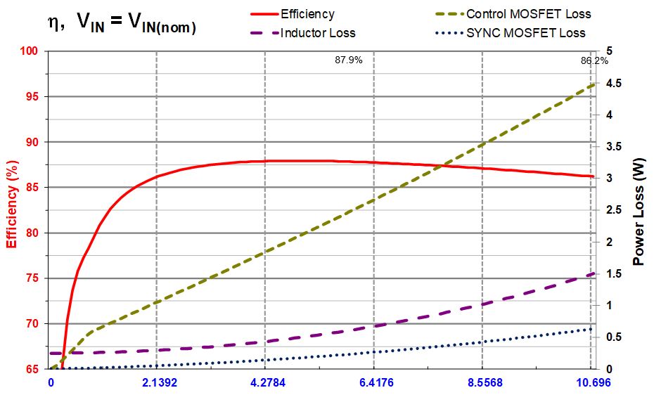

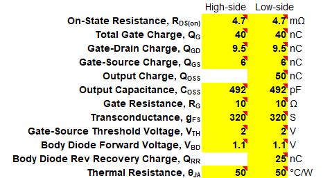

    With the excel design tool also i have a few more doubts,
    1) Row 87 is specified as  RG ,  which i assume is RHO/RLO i.e resistor connected to HO and LO pin. Is that right?
    I have kept RHO and RLO as 10R,  then my efficiency takes a major down step and goes to ~88% ( from ~ 93% if i had kept it at 1.4R ).
    My MOSFET approximate parameters are as below , and corresponding power loss figures are also shown
    You can see the control MOSFET dissipation is on higher side with 10R gate resistance. Is it advisable to keep Gate resistance in 1R range here. Or any other factors like slew rate control (EMI aspects ) come into picture there
    Im seeing for https://www.ti.com/lit/df/tidryp0/tidryp0.pdf?ts=1591205502376 a 10R is used
    but for https://www.ti.com/lit/df/tidrsr2/tidrsr2.pdf?ts=1591205504535 lower values are used.
    So what parameters exactly decide this resistance value.

  • Hello
    I believe that RG in the spreadsheet is the sum of the internal FET resistance and the external resistance.
    So you would find the gate resistance for your FET and put that in there, along with any value of external
    resistance you are using.
    Of course all of the other values for the specific FET you are using would also need to be input to the calc.
    I think that the procedure you are using is correct.  Adjust the values of the components and see the effect.
    If 10 ohms gives too much loss, then a smaller resistance (or 0) is indicated.
    Larger values will slow down the gate drive, helping to improve EMI.  At the same time larger values
    reduce you efficiency.
    So that is the biggest trade off.
