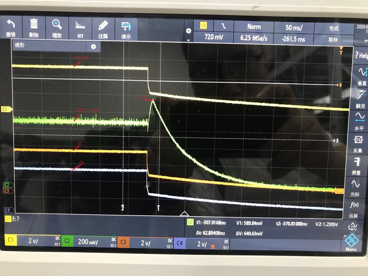

Hi team,

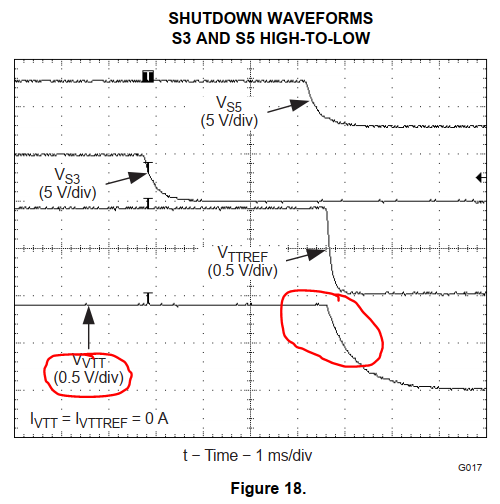

My customer is using TPS51100, VIN = 5V, VTT = 0.75V, and they find the VTT will appear a peak before decrease to zero,but the test result in datasheet does not exist this peak.
This peak will cause error to their SVS circuit error, can you help check what reason can cause this issue? And how to eliminate this peak?
Thanks and best regards
Yunjing

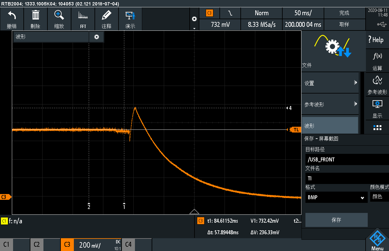

  • Hi Qian,
    Thanks for your reply, pls check below waveform with VDDQ, VIN, S3, S5 and VTT.
    And what can cause this leakage current? How can we prevent this?
    Thank you
    Yunjing
  • Hi Yunjing,
    The waveforms show VIN_5V/S3/S5 turns off first, the VDDQ turns off after a few ms.
    Once VIN_5V, S3 and S5 turns off, TPS51100 VTT pin is high impedance. Because VDDQ is still supplying DIMM chip, there is a VTT leakage current coming from DIMM, and this leakage current charge VTT up.
    This VTT leakage current existing on many DIMM modules. We see similar behavior on many customer project.
    Can you ask customer to turn off VDDQ first, then turn off VIN_5V/S3/S5?
