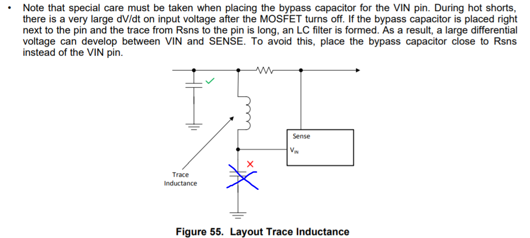

Hi TI experts,
I have LM25066A 12V hotswap design leveraged from existing project, where two 0.01uF caps are located on both side of Rsense.
Now let’s consider both C1015 and C1017 are stuffed. With two caps, can we place both of them close to LM25066A VIN and SENSE pins?
Datasheet has concern when only Vin cap is present, because in this case the LC filter will form and cause high voltage difference between VIN and SENSE pins.
But if we have both caps, the LC dumping will be cancelled from each other, hence I think the two caps can be placed close to hotswap controller pin.
Can you please share your comments?
