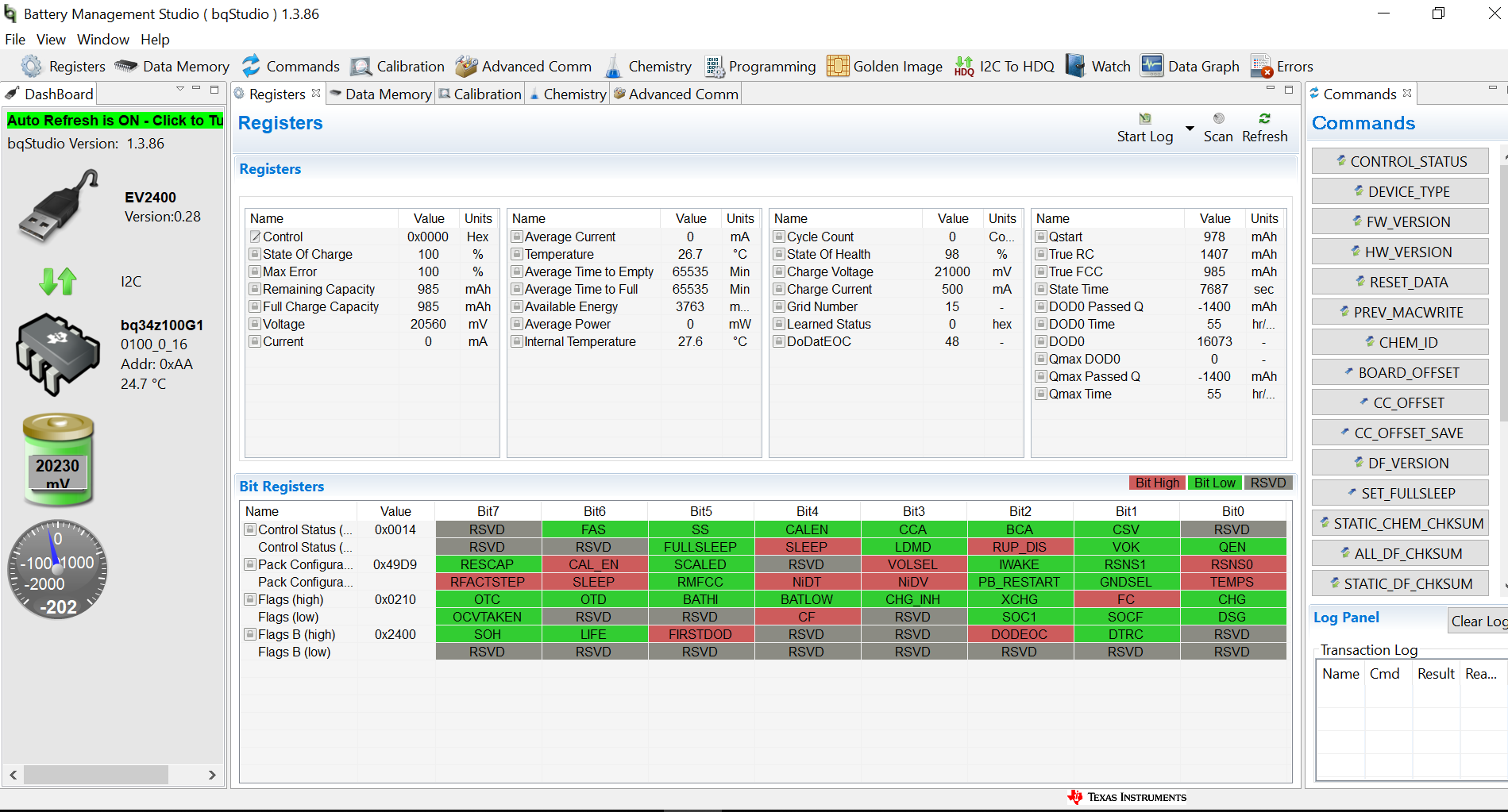

Dear TI technical support,
I have set up BQ34Z100 EMV with my battery pack. However, as I check on bqStudio, the SOC and capacity parameters seem to be not correct compare to battery specifications.
Could you help me to verify this error or the next step after I successfully set up? I think this might because I have not calibrated to chemical ID match.

    My battery pack is Lithium chemistry, 8 cells, 2.5Ah. However, the Bqstudio SOC parameter is the incorrect capacity (989 Ah at 100 % SOC), so I have questions:
    #1, what I need to configure on BqStudio before doing ChemID process.
    #2, Are the CHEMID and GPCCEDV have the same process to measure time, voltage, current, and temperature.
    #3, If 2 processes are separated if I just need relatively correct results which process are the most important. As my thought, CHEMID is the most important because GPCCEDV is just to make higher accuracy for fuel gauge, is that correct?

  • Dear Wyatt,
    I have matched ChemID and attached file is report. as Best chemical ID: 2725 ,

    I don't find 2725 in BqStudio Chemistry.  Could you help me to verify this case?
    Thank you very much,
    Cuong Dao
  • Hi Cuong,
    Can you try updating the chemistries and see if it is there:
