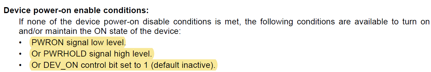

Hi Expert,
1.
PWRHOLD pin pull high can enable power output?
2.
Do you have any suggestions for PWRON pin design? I want to power on AM3352 without power button?
The key point is to set  BOOT1 = 1b , BOOT0 = 0b?
2.1
add RC to delay for L->H signal?
2.2
floating
Daniel
  • Hi, Daniel,
      Please see my answers below:
      1. Yes, PWRHOLD pin pull high can enable power output.
      2. BOOT1 = 1b , BOOT0 = 0b is for EEPROM sequence selection.
      3. PWRON pin can be floating since it has internal pull-up.
  • Daniel,
    Based on the TPS65910Ax User's Guide for AM335x Processors, if you simply pull-up PWRHOLD to VCC7, the PMIC will turn on immediately without waiting for a push-button press.
    Looking at the datasheet may confuse you more than necessary. The EEPROM programming in the TPS65910Ax device is specific to the AM335x requirements and does not require a push-button press to start the power-up sequence. For the first power-up event, I have tested this on the EVM and it does not require a push-button press. The PWRHOLD signal is controlled manually on the EVM, so this is why I said it would be best to pull it up to VCC7 through a Pull-up resistor.
