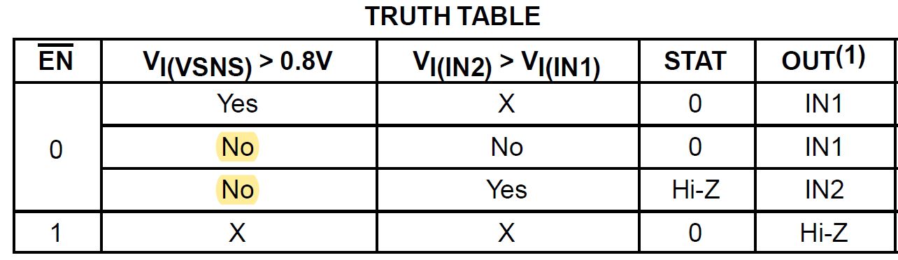

If TPS2113 no.3pin(VSNS) are N.C(floating), will they get the same result as VSNS<0.8V?
Hi Kwon,
There is no internal pull down here so this floating node is no defined. If you require the VSNS pin to be less than 0.8V at all times then it is better to connect this pin to ground.
