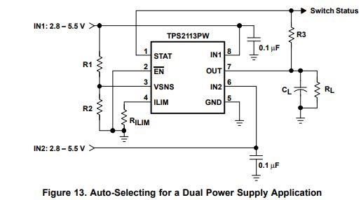

Hi~
Is there a range available for R1, R2?
Is it possible to use a divider resistor=Mega ohm to make VINS>0.8V or VSNS<0.8V?

Hi Kwon,
There is no set range for the resistor divider here. I believe MOHM should be okay but we usually use resistors in the 10 kOhm to 100 kOhm range. As always, it is the ratio of division that matters more here.
