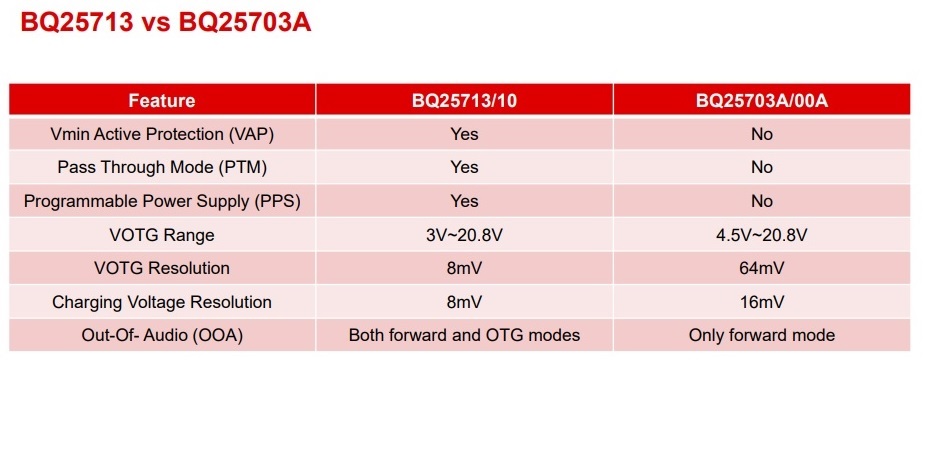

Hi Ian,
BQ25713B has different I2C address, as listed in datasheet.
Forward mode means when IC is powered by adapter while OTG is powered by battery.
