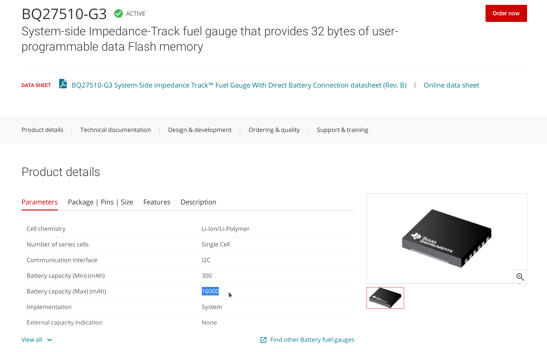

In your website, the product page says the gauge supports 16000 mAh.

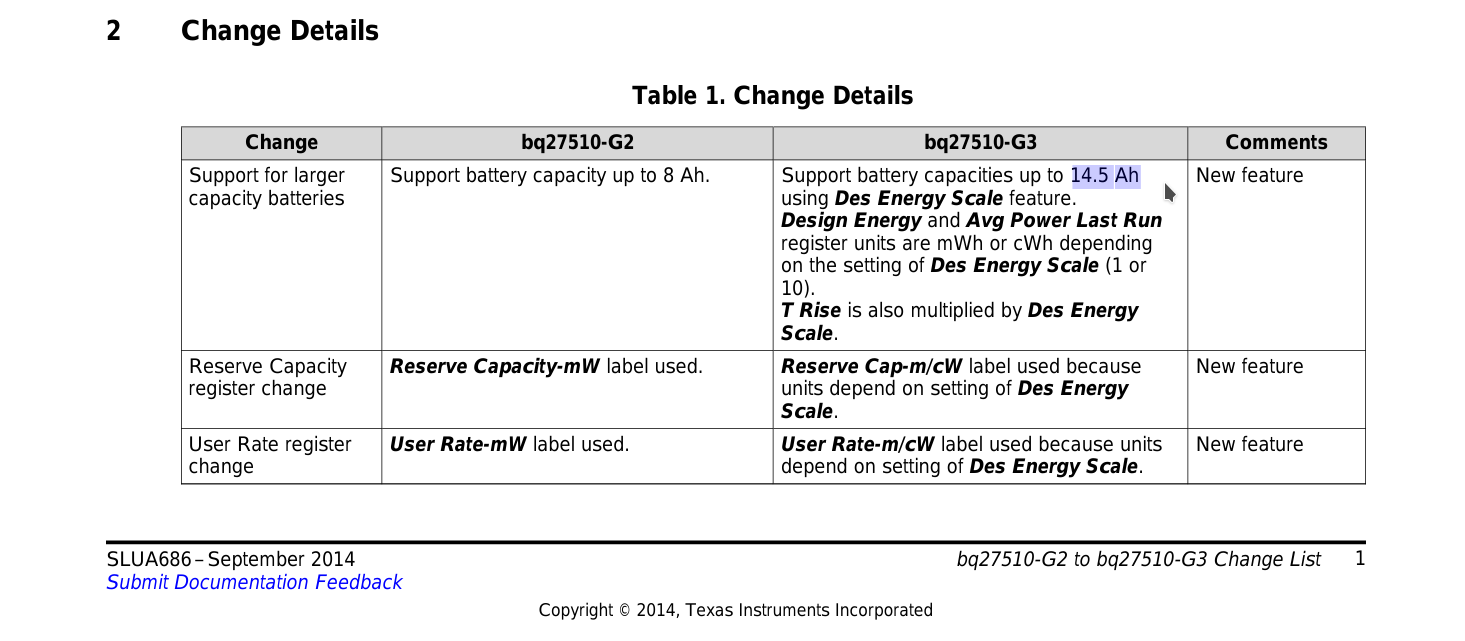

In the document bq27510-G2 to bq27510-G3 ChangeList (SLUA686, Jun. 14, 2013), it says the gauge supports 14.5 Ah.

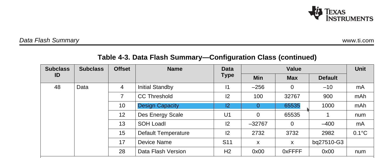

The Technical Reference Manual (SLUUA97, October 2014) didn't clearly mention this. But it says the max value of Design Capacity in dataflash can be set to 65535.
According to my practice, it seems that I could never get a 30Ah battery done calibrated. Then I started to check all documents related to this gauge and I found these differences.
This looks like a joke!!! I have been testing with batteries of different capacities for more than half a month and then I get this???
Please tell me which one is correct???
