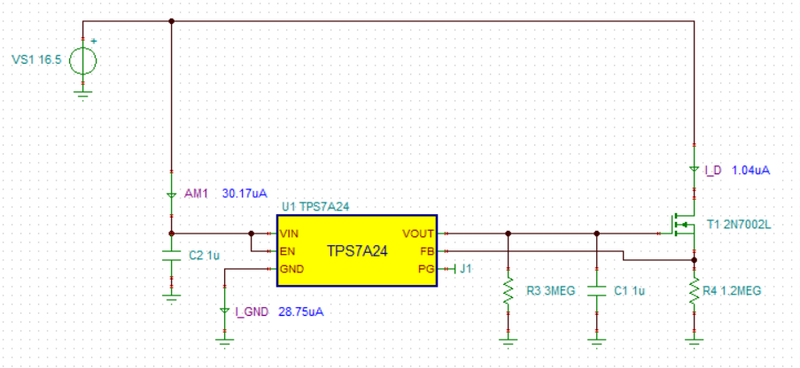

Is Iq of the TPS7A24 not modeled?  I put together the following simulation to create a precision 1 uA current sink and the Iq of the TPS7A24 is more than 10 times the expected value.  Seems like you would try to model the Iq of an ultra-low Iq regulator?
TPS7A24 current source.TSC

  • In case you're interested, this is the full circuit of my simulation.  The TPS7A24 is used to create a 1 uA bias that drives the PMOS source follower (T4) effectively creating an ultra-low Iq NEGATIVE regulator operating from the input rail.  The voltage source D_CELL can go up to 18V, so this is enables using low voltage devices on high voltage rails.

  • This circuit is my original work.  I was hoping to find an integrated low Iq negative regulator but as you know, TI doesn't make anything suitable. If you think this would be a useful app note, I can work on writing one.
    I have no requirements for accuracy on the negative bias, so the source follower and the variation due to Vth was not a problem.
    I've attached the TINA simulation for this ultra-low Iq ideal diode circuit.  You can run both DC bias and transient simulations.
    -Steve
    Ideal_diode_revised.TSC
