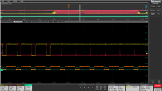

I have designed a SiC-based three-phase 3-Level T-type NPC voltage source inverter for a motor drive application.
I am using the UCC5390 gate driver by TI to drive the MOSFETs.
The converter switches normaly at a switching frequency of 500Hz.
 In frequencies higher than 25kHz the gate drivers' output voltage gets clamped on +VCC2 while the input is a pwm signal.
The result is shorting the phase.
I attach the figure.
Is it a known issue? Is the gate driver not rated for high frequency operation?
Thanks in advance. I am looking forward to hearing from you.
Giorgo

    I am using UCC5390S, the 10A/10A split output configuration.
    I attach two screenshots of the schematic. I have used two configurations and have the same problem.
    The values of Vcc1 = 5V, Vcc2 = +15V, Vee2 = 3.3V. The voltage of the input pulses can be arbitrarily chosen to be 2.5V, 3.3V and 5V.
    Giorgo

    I am trying to switch two SiC MOSFEts at 25kW. The models of the MOSFETs are C2M0080120D (http://www.farnell.com/datasheets/2047787.pdf) and C3M0065090D (https://docs.rs-online.com/3a4d/0900766b8149fd4d.pdf). They should be able to switch at several hundreds of kHz.
    The input signals can be seen in the original post. The first figure is the gate-source voltage of the MOSFET. The second is the voltage between pin-6 and pin-08 of the gate driver. The third figure is the PWM. While the PWM switches the Vgs stays the same.
    I have been measuring the case temperature of the gate driver using an infrared camera and it is lower than 40oC. The calculations regarding the heat dissipation wield Pgdq = 1.0281W and Pgsw = 22.5mW. The junction temperature is calculated at 44.226 oC. The results are overrated due to not being able to measure Icc1 and Icc2, so I take in account the current supplied to some differential amplifiers and their power supplies.
    So, the conditions are within the specifications of the device.
    I hope I have provided you with sufficient data.

    I have observed that by reducing the Vcc1 voltage, the gate driver switches correctly at 25kHz. I will do more testing at 50 and 100kHz.
    Thanks in advance. I am looking forward to hearing frrom you.
    Giorgo

    Do you have some kind of resistive load on the input circuitry which is dragging it down? In your original post, the PWM isn't getting up to 5V.
  • Hi Don,
    No there is no resistive load.I am using an FPGA and the output is controllable. The output can be set to 2.5V, 3.3V and 5V, so I was testing to see if I can get rid of the clamping.
    Giorgo

    In the figure to the left, the Vgs output of the gate driver can be seen with the VCC1 and PWM signals' amplitude of 5V. It is the complimentary transistor of the original figure. The specifications of the datasheet were followed. It can be observed that one of the transistors is getting clamped to +VCC2 and the other one is getting clamped on -VEE2.
    Is there some explanation why this is happening? This malfunction has damaged two inverters and costed me 6 months of developing and debugging.
    After some trial and error, with a PWM signal of 5V and a VCC1 of 3V, the Vgs voltage to the left was achieved. The signal integrity is better but there are still false turn-ons or the gate driver doesn't turn-off when it should.
    Is there a solution to this problem? Is there another component that could be used?
    Giorgo

    I have taken measurements using a smaller timebase. The VCC1 is 5V. The PWM is switching between 0V and 5V.
    The switching frequency is 100kHz. On the bottom axis the PWM signal can be seen. On the top the Vgs signals can be seen. The The Vgs does not follow the PWM.
    At higher duty cycle the waveforms look like the following:
    At zero crossings, where the duty cycle is smallthose waveforms can be observed:
    And I have also taken some extra measurements using a timescale of 20us/div:
    I still don't understand why this is happening.
    Giorgo Kapino

  • Hi, Giorgio,
    This is very strange. I can't explain why the output stops switching and stays HIGH for some time period before recovering.
    I worry maybe the chip is damaged from violating the Absolute Maximum Ratings for it. Have you swapped out the driver and seen the same behavior when driving everything under the Recommended Operating Conditions?
    In your 3L converter, is this occurring in the half bridges or the back-to-back switches? How are you powering your drivers?

  • Hi, Giorgio,
    OK, we discussed this issue internally, and this is our feedback:
    1. Did you short out D21 in these measurements?
    2. We think the input PWM signals aren't accurately getting to our device. Ch1 turn off doesn’t follow Ch5, there is a fixed delay. So, we think maybe your PWM signals aren't getting to the inputs of our chip correctly.
    It is also interesting how your signal goes away, and then comes back later. It looks like this might be happening at the peak of your motor current waveform? Maybe ground bounce is coupling into the inputs, causing them to not receive the correct signal?
    Is there someone at your university who can put a second set of eyes on this locally?
