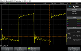

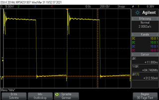

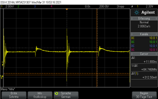

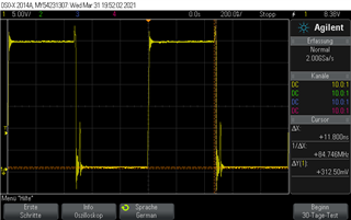

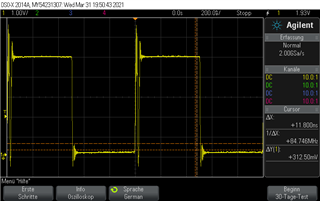

With the LMG1210 I unfortunetly have some EMI/EMC problems during the dead time. It seems like, that the BST Pin is coupling troubles in my PWM path. The driver detects it as a switching. I am using the inverted topology of a buck converter:
The operations are: Vin = 30 V , Iout = 3 A , duty cycle = 0.5 , fsw = 1 MHz
Here are some Signals I measured (PWM, Low Output, High Output, Vds Q1, Vds Q2, BST Pin):

    Unfortunetly I am not able to insert images here. In my first post I just clicked and droped it in the text box, which worked. Now I cannot choose or select the URL to post the signals/images here.
    The signals/images above are:
    ( 1: PWM/LI                                        -                 2: LO Low Output )
    ( 3: HO High Output                           -                 4: Vds Q1 )
    ( 5: Vds Q2                                         -                 6: BST )
    Please let me know if I can help any further.
    Kind regards
    Stefan

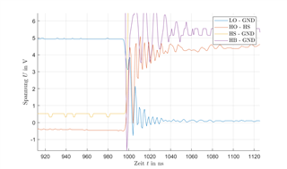

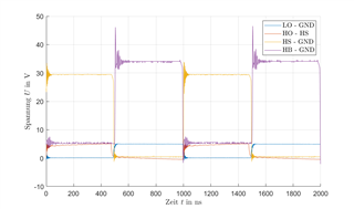

  • Hi Leslie,
    in this situation I measured the signals and plotted them in MATLAB.
    LO-GND , HO-HS , HS - GND , HB - GND:
    PWM(LI) - GND , LO - GND , HO - HS , (About VDD - GND I will send you next week another plot. I can only say, that it also has bouncing through the bouncing GND):
    In my opinion, GND itself is bouncing way too much caused by the HS - GND switching. About my measurement methods, I am using spring clips to measure short distances between the signals. On the backside of the board, I have testpoints, which are close to gate resistors.
    Please let me know if you have further questions or need more/precise plots.
    Kind regards
    Stefan

  • Hi Stefan,
    There is lot of noise in the gate drive path either related to layout and/or high di/dt through the transistors.
    There are several techniques to mitigate this including slowing down the switching speed by tuning your gate resistances and/or adding Cgs capacitors at the gates. High switching speed coupled with parasitic in the gate drive portion will result in significant noise especially when proper grounding is not accounted for.
    You may also increase your input capacitor on LI (<300pF) and adding small series resistor for filtering on INx signal.
    We typically recommend the driver very close to the power transistors while ensuring a small GND loop return from FETs source to driver GND in an effort to limit gnd bounce influence and noise specifically with high dv/dt applications.
    -Mamadou

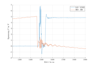

  • Hi Leslie,
    as promised, the scope shots with VDD to GND:
    I have already three PCB's with the LMG1210, unfortunetly no one does work properly. The gate path (Q1) in two of my three layouts look like this:

  • Hi Stefan,
    Few points from your latest waveforms.
    1. During the rising edge of the HO_HS, there appears to significant ringing on the supply which likely points to either insufficient filtering on the bias. The second possibility more likely based on your 2nd and 3rd waveforms is shoot-through event where both HO and LO are high. On both the waveforms, LO and HO appears to both be high simultaneously.
    It seems that LO has a certain delay before responding to LI low commands which intersects with the HO low to high transitions. Can you confirm your dead time and actual prop delay measured? From the plots, it looks like the prop delay is >=35ns, can you confirm?
    2. The Cgs capacitance and gate resistors will help slow the dv/dt and will help us understand whether there is any improvement while we figure out the root cause of the issue. I assume while you have been collecting the latest waveforms that VDD has the previous capacitance values that Leslie previously recommended.
    3. The gate drive loop appears fairly small though we want to confirm that VDD caps are directly across the IC VDD/VIN pins.
    -Mamadou
  • Hi Mamadou,
    1) The surface of the switching node is huge, which makes the the HO - SW signal increasing during its on time.
    The dead time is 15,5 ns due to 33kOhm resistors (R1 and R3). I can measure the dead-time at the Drain-Source, which gives me around 15 ns. When I measure between LI falling and LO rising, I can measure a time of 33 ns:
    2) The VDD input capacitors are 10 uF and 100 nF for high frequency filtering. In my opinion, the VDD voltage is ringing because of the ground bouncing and not because of a pulse current. Here are two different Layouts with different placings:
    Thanks for your patient. Kind regards
    Stefan

  • Hello Stefan,
    I am referring to the last waveform plot you shared shown below where both LO and HO are >3V. Can you increase dead time (LO going high and HO going low) to confirm whether there is any improvement.
    The long traces from VDD caps and pins may not be effective to filter out the supply. Long traces will add stray inductance which will cause further ringing. You could try a smaller package resistor (not sure what you currently use) and move the caps closer to the pins. Please note that you need to separate local decoupling capacitors on both VDD AND VIN as shown below.
    We typically recommend the decoupling caps across the pins as shown below to effectively filter out noise on those pins. If GND bounce is the actual issue, 2 things to mitigate and confirm: (i) slow the dv/dt at the gate which will also slow the di/dt through the FETs (ii) increase C38 caps to 100 to 200pF to check whether there is improvement and (iii) further reduce the gate
    -Mamadou
  • Hi Mamadou,
    here are the signals you asked (LO high, HO low) with a dead time of 20 ns:
    For my next Layout I can change the position of the VDD caps as you mentioned.
    Changing the C38 results a better behaviour of the PWM signal:
    I further increased the gate resistance to 2 Ohms, which results to way better signals compared to the last measurements.
    As you said, dv/dt or di/dt of the switching is may the cause for the trouble. In the last layouts I orientated myself on TI's HVP012A.
