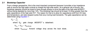

    Additionally, can you help me to confirm the size of my bootstrap capacitor, given the previously stated 70 nC gate charge, and given that I am running at 12V for VDD?
    I saw an app note (SLUA887) that said this:
    In my case, this would be roughly 60 nF I think. Would 0.1uF be a good place to start?
  • Hello Justin,
    Since you are looking at an application that may have long HO on times or low frequency, I would refer you to the UCC28272 datasheet which is a similar 100V half bridge driver but has more detail guidance on sizing the bootstrap capacitor. The driver IC HB quiescent current will discharge the bootstrap capacitor over time which you should account for that. Look at the application example section which includes guidance for the bootstrap capacitor based on frequency and duty cycle. Use the IC parameters from the UCC27211, and the design steps in the UCC27282 datasheet.
    The 100nF cap you mention is adequate for supplying the MOSFET Qg but may need to be increased to hold up from the quiescent current over time. Also if you have a gate to source resistor that will discharge the bootstrap capacitor as well. Add the current thru the gate to source resistance to the IHB in the equation.

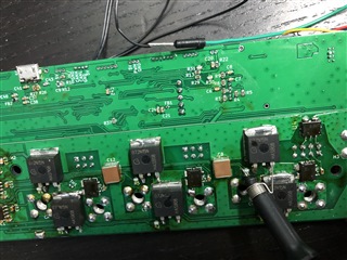

  • Hi, I managed to get things working a little better and now I'm doing a complementary PWM strategy that seems to be running the motor ok at low speeds. Now I keep burning up my phase C UCC27211 driver. I have probably burned up 3 drivers already and pretty much all at high speeds. Phase C is the farthest half bridge away from the UCC27211 also.
    Do you think it could be a layout problem? Perhaps it's pushing the gate signal distance a bit too much.
    This is a 2-layer board and all the signals from the 'mother' board come in on the header on the left side. I can also share layout files here if useful. What is the most common cause of a UCC27211 heating up and failing to work under operating conditions?
  • Hello Justin,
    Layout can definitely be a concern regarding stress to the driver. I do have one question. When you mention complimentary PWM strategy, is there a single PWM control signal and operating the driver with a complimentary high side and low side output? I ask this question only because it is important to have some dead time in the driver outputs between the high side and low side on times.
    With a long gate driver to MOSFET trace loop, there is a good chance that there may be voltage overshoot and undershoot on the gate driver outputs relative to VDD and ground, or relative to HB and HS.
    Confirm with scope probes that the LO, HO and HS pins are within the datasheet recommended operating range. There may be excessive voltage on the gate driver outputs or possibly the HS pin.
    If there is voltage overshoot on the driver outputs, this can be improved by increasing the resistance from the driver to the MOSFET. This will slow the switching dV/dt and help dampen the voltage ringing caused by the layout trace inductance.
    Confirm if this addresses your questions, or you can post additional questions on this thread.

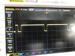

    Here are some more details. I was doing some oscilloscope experiments with a new chip and got these results on phase C, where the gate driver is always failing:
    Probing high side MOSFET gate to source, during switching, with no load:
    high side gate source - no load switching
    Low side:
    low side gate to source - switching with no load
    I also probed before the gate resistors on each, with a noisier result:
    Do the spikes on the high side drive seem to be the culprit? They are upwards of 20V, at least from the scope.

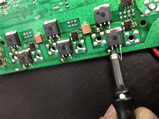

    Finally, here is an example of the low side switching that happens during loading (with a motor attached, but at low power):
    Finally, I wanted to mention that if I run the motor at low speeds, everything seems fine and the chips are all cool to the touch. When I increase the duty cycle, the chips seem to start heating up and eventually phase C gate driver seems to be the first one to fail.
    What could be the reason for heating up substantially during operation at higher loads and failing? I'm assuming it is transients that are starting to damage the chip internally.

  • Hello Justin,
    Thank you for the update. With the pin comparison measurements, to me it is a bit inconclusive since many of the measurements are either very high impedance or showing out of range. The one you mention with the boot diode difference, VDD to HB, on the device that has the short you mention I assume the VF is very low, not 0.6 to 0.7V. Please confirm.
    The plots you show with the voltage spikes on the drive are a concern. There may be Vgs perturbations from the MOSFET switching which may false trigger the MOSFETs.
    With the long distance from the driver to at least 2 of the MOSFETs this is not unusual.
    One thing that helps with this is to have some capacitance right on the MOSFETs gate and source pins. This helps stabilize the Vgs from the miller charge that is transferred to the gate during switching. With long traces from the driver to MOSFET, the driver has limited ability (due to the trace inductance) to clamp the Vgs.
    Also, can you confirm that the driver LI and HI pins do not have voltage spikes that may false trigger the driver? If there is noise on LI and HI try adding a small R/C filter, start with 50 Ohms and 100pF.

    The main question I have now is what could be causing the chips to heat up during operation at higher loads? Do you know of what can cause them to get hotter when at higher loads? Is the fact that they are getting hot indicative of damage or out of range voltage spikes on certain pins?
  • Justin,
    There are a couple of possibilities. At higher loads the power MOSFETs will have higher temperature rise, the close location of the driver to the MOSFETs could be thermal conduction back to the driver.
    If there is false triggering of the driver this will increase the frequency of the driver which will increase which will increase the driver power dissipation.
  • Hi Richard,
    I don't think that the MOSFETs are rising in temperature at all, or at least not significantly. Whereas the driver chips seem to be rising pretty quickly up to > 70 deg C. The false triggering could be a possibility too, as you mentioned.
    Do you know if heat would be produced if the maximum voltage specifications were repeatedly being violated on the bootstrap or HO/LO pins? Or would heat in this case be indicative of irreparable damage?
  • Hello Justin,
    It is possible if the voltages on the IC pins are beyond the datasheet recommended ranges that there could be additional current into the IC. I would confirm the HO, HS including negative voltage, LO & HO including overshoot/undershoot.
    Also confirm my previous suggestion that the gate driver is not false triggering and generating additional pulses that are not intended. Even narrow output spikes from the driver will add to the gate drive loss.
