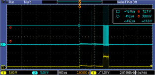

The output and the different voltages in the diferent nodes of the channel 1 are as follows
Output voltage:
Coff node:
UVLO node (see that V_uvlo=1.3v when En1=0V and V_uvlo=2.1v when EN1=12V:
Dont really know what is happening. Anyone can guide, please?

    What is your current sense resistor value, I cannot read it on your schematic?  Is it 0.091 ohms?  If so I get about 2.7A peak and 2.6A average switching at 600 KHz.
    You may want to change the volts/division to get more resolution.  If UVLO is 1.3V it should be on or close to it since UVLO threshold is 1.243V.
    If you can zoom into the Coff voltage you can see if it is reaching 1.243V and if it's switching when the output is high.  Again I would change the volts/division for more resolution.
    It looks like the first picture is running in maximum off-time mode.  There is a little spike on the output voltage at about 300 us and then the output rises 300 us after that (appears to be two maximum off-times).  Is there any capacitance across the LEDs?  Is there any resistance across the load?  Is the load actually the leds or is there some other load?  What does the output connection look like?  Have you powered the LEDs with a lab supply to see what the voltage across them is?
    Zooming in to the spike along with Coff can show if you are getting a full on pulse.

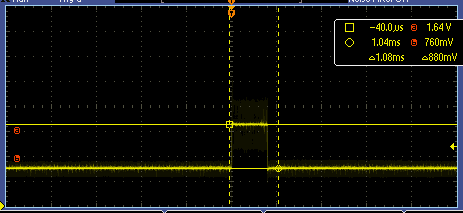

    Regarding the UVLO voltaje:  this is what the UVLO shape looks like. zooming more than before I found 760mv when EN1 is off, 1.64 when is ON

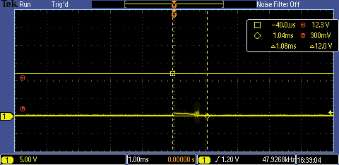

    Regarding the Coff Pulse: It is 0V (noisy) when EN1 is off. When EN is turned on, the voltage of Coff is 728 mV, that are decreasing auntil a moment where  a "Spike" of 1.34V is reached, don't know the reason
  • Hello Gonzalo,
    Thank you for the information, UVLO seems to be the correct levels.
    Can you look at VCC over this same time?  Can you also look at the gate waveform, Pin6 and also the switch node (the inductor connection tied to the mosfet and diode, left side of the inductor on your schematic)?
    If is no output capacitance then what may be happening is a leading edge blanking problem.  You will have to zoom in to see how wide the Gate/switching node pulses are.

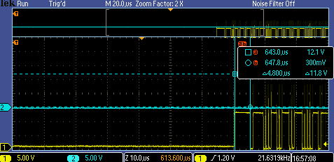

    VCC look almost flat at 12 V, except there is some noisy peaks in the moment of the "final peak" inside each pulse (Yellow Line SAL1, blue line VCC)
    Pin 6 looks like this: (Yellow Line SAL1, blue line PIn6
    In the first part of the pulse, Pin 6 is about 780mV
    I have basically no Gate pulses during the first part of the pulse. In the second part of the pulse, I have 4.8 us ON, 1 us OFF
    Last question. The switch node looks exactly as Pin 6
  • Hello Gonzalo,
    This can be confusing since this is a P-FET driver.  When off the MOSFET gate should be at Vin, 12V in this case (switch node should be near a diode drop below zero volts if there is inductor current).  When on it should be approximately 6V, VCC voltage (switch node should be 12V).
    The first picture should look be approximately 6V if Vin is 12V, make sure you are looking at pin 9.
    The second picture the gate drive, pin 6 should be at 12V going to 6V when it is on (scope referenced to gnd).
    The third picture doesn't appear to be the gate waveform, pin 6.  you can look at the gate of the MOSFET if that is easier.
    The fourth picture shows the LM3409 running after a couple of maximum off-time pulses.  Normally this happens with output capacitance that cannot charge Coff to 1.243V, it appears there are leading edge peak current trip pulses when it is running (the narrow  pulses when it is on).
    The sixth picture, Pin 6, the gate, should not look like the switch node, it should get pulled from 12V to 6V when turning on and go back to 12V when off.
    The MOSFET doesn't appear to have too large of a Qgate for false current trip, perhaps the layout is causing issues with the current sense.  How many layers is the PCB you are using?  If you can set the time base to 100 ns and trigger on the first switch node pulse you will probably see a very narrow pulse of 115 ns (typical).
  • Sorry,
    I chose Vin instead Vcc and switch node instead gate pulses. these are the graphs:
    VCC(you were right, 6 V)
    Pin 6, with detail in the pulses. (From 6 V to 12V) . As it has been noticed, there is a big time lapse  (600us) where I basicaly don have this gate pulses during EN1 =ON
    The pulse time detail. From 5 us (ON) tu 1 us(OF) aprox
  • Hello Gonzalo,
    Vcc looks good.  If you look at the second picture (blue trace) you can see a very narrow pulse, if you zoom in on that I would suspect it is approximately 115 ns.  There will be another on 300 us later.  At 600 us the LM3409 appears to start running.  The maximum off-time is 300 us.  This happens if Coff does not reach 1.243 volts.  It cannot reach 1.243 volts if the output voltage did not rise (common with large output capacitors) but can also be caused by a minimum on-time pulse since not much energy goes to the output.
    On your last two pictures you can see the first two on pulses, which is good.  The next two attempts appear to be minimum on-times.  This can be caused by the MOSFET Qgate being too high.  This one is under 30 nC so it should be okay.  Next would be layout.  Is this circuit on a one layer PCB? two layer Printed circuit board or is this a breadboard/proto-type?  If there is inductance in the current sense path it could be false tripping the peak current sense comparitor.
    You can, as an experiment, place a 50K (49.9K is 1% value) from Coff to Vin if Vin is a stable 12V.  This will allow Coff to charge to 1.243V.  The real fix is to figure out why it's only providing a minimum on-time, first step with that is to see how wide the on-pulse is at the beginning (600 us before it is running).  I think that's where your trigger point is set (near the second division on the left).
