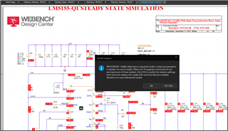

The Reference model on Pspice for TI can not be simulated on default condition, the following message appears.
Could you improve it?

Hello Kuramochi,
Thanks for reaching out. The message is telling you that since in the schematic a diode and a mosfet are used, then you need to add at least one marker (e.g. a voltage marker on the Vout) in order to start the simulation.

Hi Kuramochi,
Please try to add the marker and check if the simulation can run. Let me know if I can help you furthermore.

Hello Kuramochi,
Did you check if the right simulation profile is selected (from the drop down menu on the top in the middle)?
