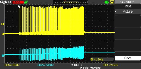

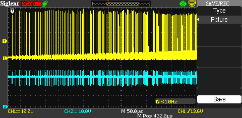

    For #1, what is your input voltage and your target battery voltage? Could you post waveforms of PH, VCC, and SRN on the same scope capture?

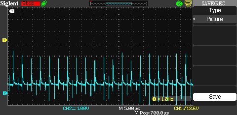

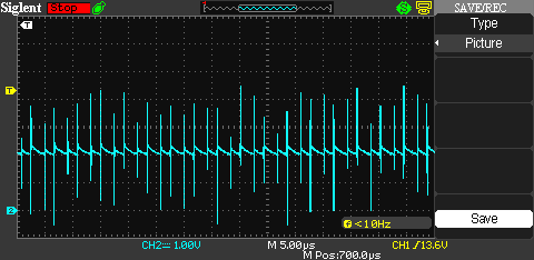

    For #2, what is the measured voltage on ISET1 during this issue for each of your settings?

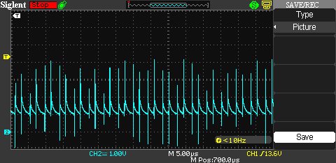

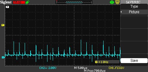

  • I only have a 2 channel scope, so I had to capture it in 2 steps but I think you'll understand how to combine them.  See the attachments.  I have noticed that the presence of the scope probe especially, but the multimeter as well seem to produce a noticeable change in the charge current, especially when probing the ISET1 line.  In all cases it seems the stray capacitance helps a little bit (of course the scope probe doesn't have much capacitance either), so I will fiddle a little bit with adding capacitance to that line in varying amounts.  It certainly may help with all the switching noise seen in the waveform captures of the ISET1 line in the attachments.
    Input voltage is 24V from an AC/DC converter (200W class).  Target battery voltage is 14.6V.

    PH (yellow trace) vs. VCC (24V RC filtered)  Note the input voltage seems to exhibit the same type of loading and unloading spikes at the input to the board as well.
    PH (yellow trace) vs. SRN (shows the first burst cutting out when SRN reaches the ~2.3V)
    ISET1 at 2Amp setting, measured 0.487V on the multimeter and SRP-SRN = 20.1mV
    ISET1 at 2.5Amp setting, measured 0.620V on the multimeter and SRP-SRN = 24.8mV
    ISET1 at 5Amp setting, measured 1.115V on the multimeter and SRP-SRN = 36.0mV
    ISET1 at 10Amp setting, measured 2.082V on the multimeter and SRP-SRN = 48.6mV

    From a component connection perspective, there is nothing wrong, but there is a lot of noise on your signals. I just noticed in your schematic that you only use a single GND connection for the charger. This is most likely injecting noise to prematurely shut down the converter. This is why adding the scope probe is changing the behavior of the battery charger. The IC datasheet calls for using a signal GND for small signal pins and a power GND for the switching converter. See Fig 1 in the datasheet and page 28 for layout guidelines. Fig 1 uses two types of GND that are tied together at a single location. You can also see the EVM schematic and layout in the user's guide for further examples of a good layout and grounding techniques.
    For example, SRP/SRN are inputs for a differential amplifier. C9 serves as a common-mode filter to the amplifier inputs, and C11 serves as another filter for positive input of the amplifier. However, since you are injecting noise from the switching current into the amplifier, the charger is not able to accuratly sense the current through the resistor. The spikes on SRP/SRN could be causing an overcurrent or OVP condition on those pins, causing the converter to shut down. The same applies for the VFB pin.
  • Thanks for getting back to me on this.  I found that bypassing the ISET1 pin helped a lot with the noise on that pin so I will be incorporating that in the next pass.  I also compared the GND plane on the back of the board to the working version that used the 26420.  I only have a 2 layer PCB to work with.  On the older version the GND plane was significantly more solid especially as regards the PGND returns.  So I tried bridging a few of the GND islands together using a bit of copper solder wicking braid, and found that this makes the board work correctly.  In particular the FETS returned to somewhat isolated GND islands that had relatively thin connections to the rest of the GND fill.  Anyway, the discovery issue is gone and so is the charge current issue as well.  The next pass of the board I will focus on this issue and make the GND fill as robust as possible, especially for PGND returns.
