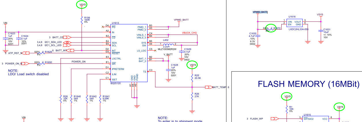

We are using BQ25120 in one of our designs.
Below is the observation ,
Without the battery connected ,
  1. When USB is plugged in PMID_1 and PMID_0 comes up.
  2. When USB is plugged out and plugged in suddenly PMID_1 and PMID_0 does not  come up.
  3. Plug out the USB and wait for 10-12 seconds and then plug in the USB then PMID_1 and PMID_0 comes up.
Is this because PMID_1 and PMID_0 has to ramp down completely before the next power on.I have a 4.7uF CAP on the output of PMID_1 and PMID_0.
I even removed 4.7uF CAP and now it works most of the times but still PMID_1 and PMID_0 doesn't come up sometimes.
Could you please help me in understanding what is happening.
I have attached the SHC for your reference.
Thanks in Advance.
Awaiting your earliest response.
Thanks ,
Rajesh N
  • Rajesh,
    I believe you are using the earlier version of the silicon where we had a requirement of BAT to be >1V or less than 0.2V for PMID to come up.
    When you unplug and re-plugin, can you plot the BAT voltage at this point? The capacitor on that node might be just charged enough to be on this voltage range.
    Is your planned use case with a real battery?
    Gautham

  • Sam,
    On the older revision of the IC- We would want to avoid VIN plug when you are having BAT from >0.2V and <1V.
    Gautham
