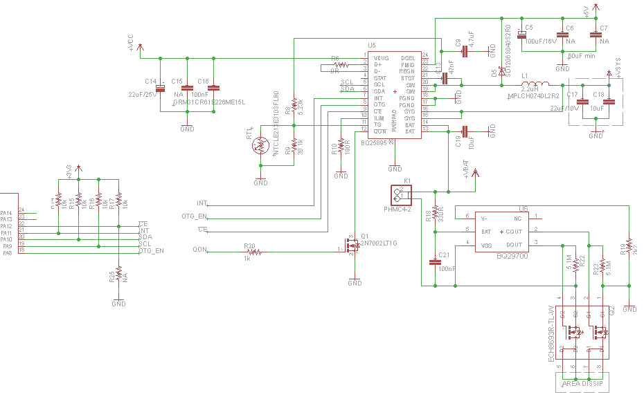

I am using a BQ25895 on a powerbank (with 5x Li-Ion 18650) and I had some problems with battery charge.

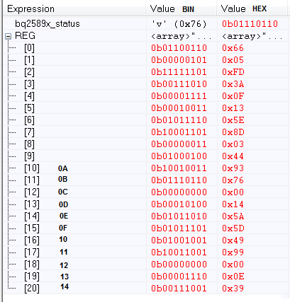

When it is powered by battery, the PMID boost mode works, but when I connect the vbus to 5V, the battery aparently dont charge: The ICHGR on REG12 is aways zero. At this moment, VBAT is 3.8V.
The REG0C has no faults.
Curiously, the REG0B swing from 0x76 to 0x7E and back to 0x76 eventually.
A attached the print of registers and schematic for reference.  Actually the R10 is 330R (for test).
Anyone have any idea what might be happening?
