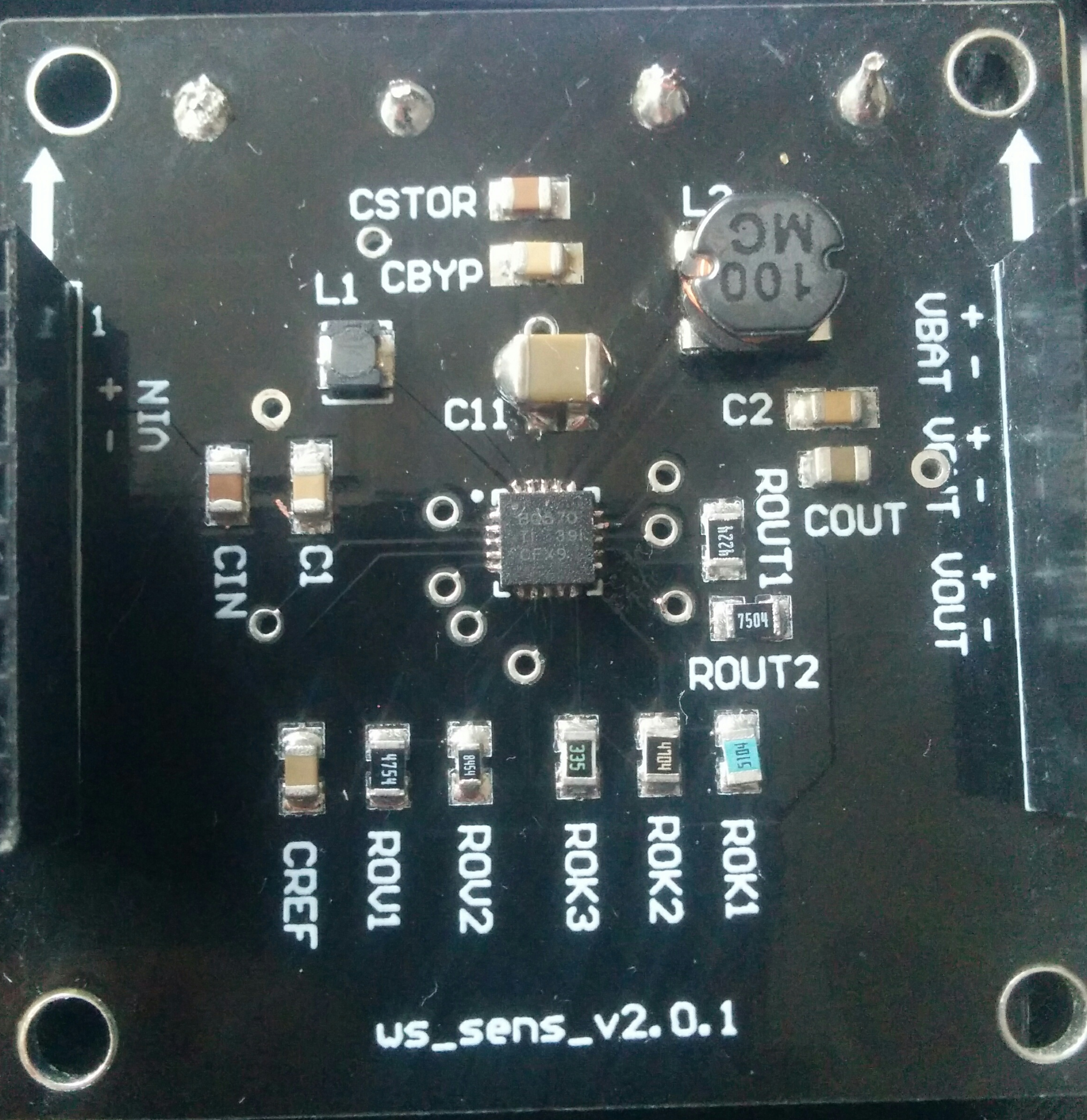

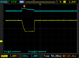

I'm still facing an issue with my bq25570. Indeed, when it is in charging mode, that is to say when a voltage is applied on VIN, VOUT can falls downs in unregular way under 2V that makes my CPU to reset.

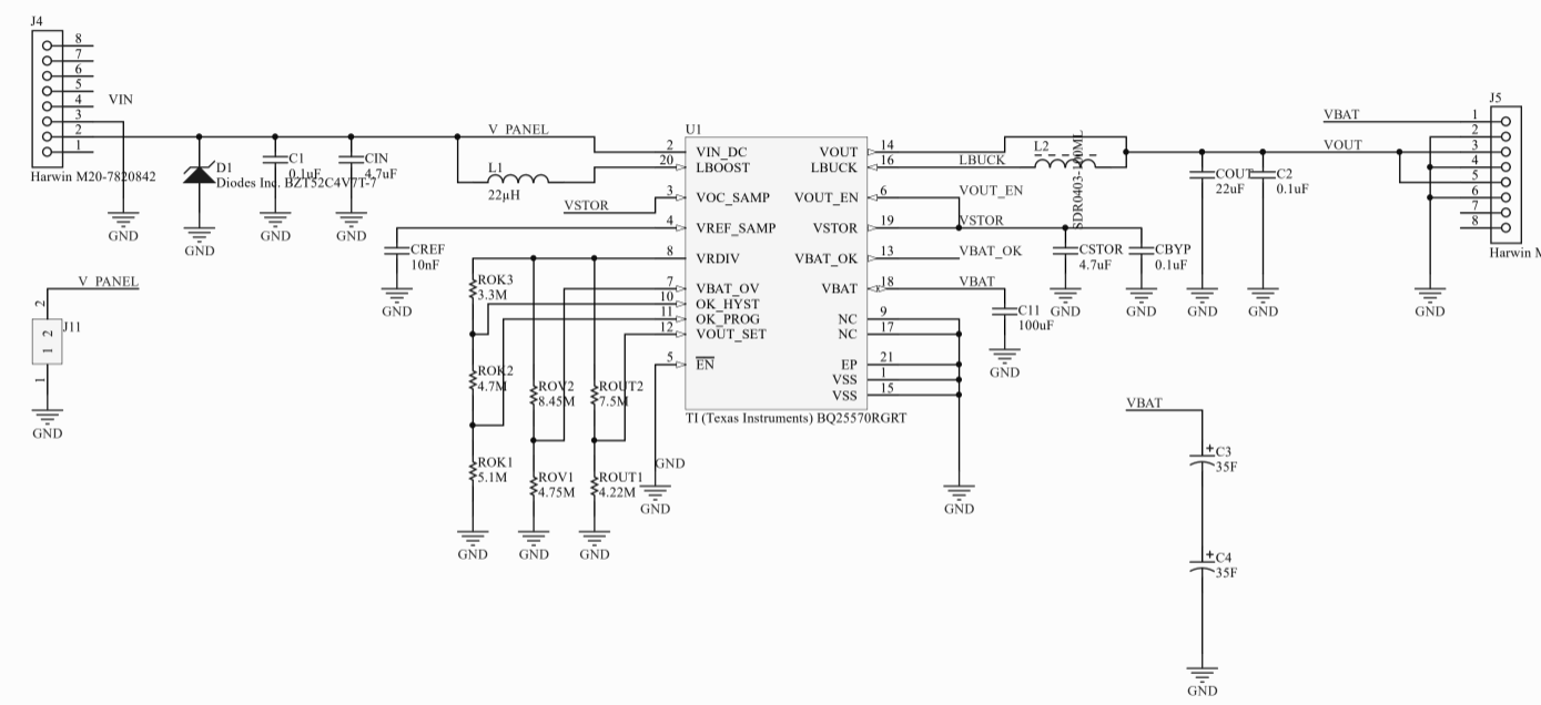

The following setup is implemented:
  • The energy source is a solar cell : 0.42W - 3V
  • The storage elements are two supercap of 35F (2.7V) put in series
  • VBAT_OV = 5.04 V
  • VOUT = 3.36 V
  • VBAT_OK_PROG : 2.32 V
  • VBAT_OK_HYST : 3.10 V
VOUT fall down most of the time when a radio frame needs to be sent but not necessary, it can also occurs when the CPU wakes up. (Just for your information, a radio frame will loads arround 50mA for arround 1 or 2 seconds or even more). When an instability has been triggered, it seems that the system stays unstable for a certain time ... The instability can stop by itself or as soon as i cover the solar panel .... Sometimes, the VOUT drooping can occur after several hour without issue ...
I have one board on which all is OK, it didn't reset for more than 20 days. and it continues running well and sending arround 60 radio frame each day.
I thougt that putting a capacitor of 100uF on VBAT pin would solve the problem, but it didn't, i have also tried to increase CSTOR and COUT up to 100uF but without success, it was even worse ...
Here is my schematics :

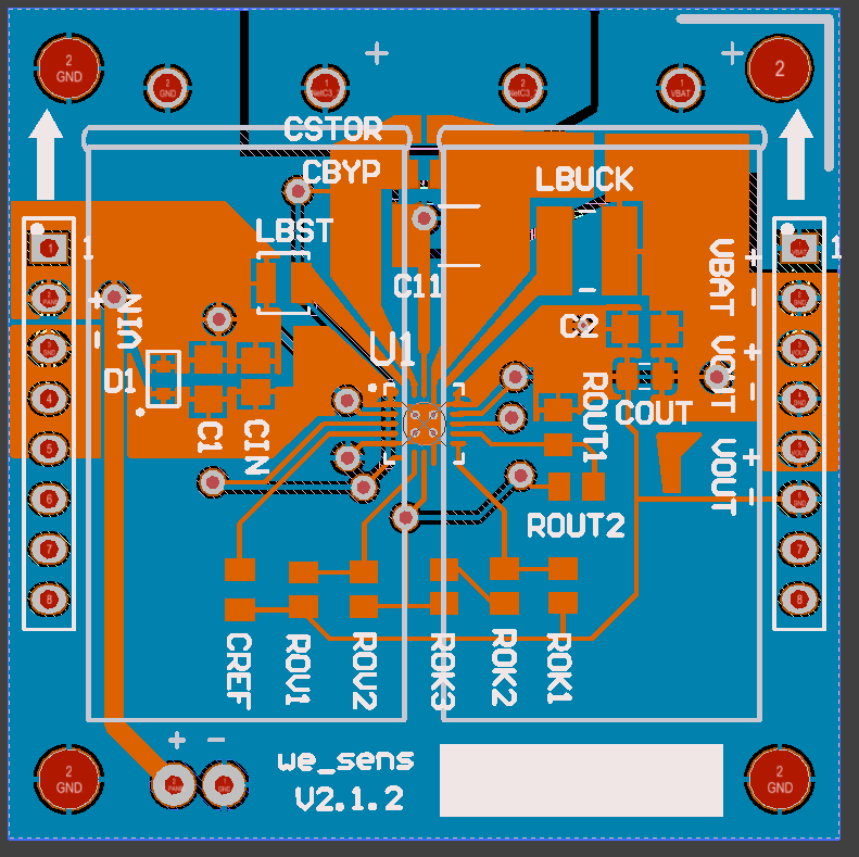

Here is my PCB :
Here is a photo of the board :

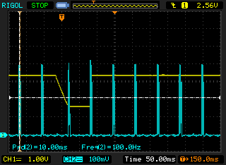

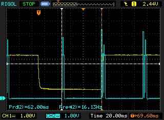

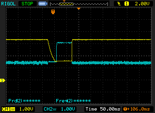

Here are some screenschots :
VOUT (Yellow) and VSTOR (Blue) :     VOUT (Yellow) and VIN (Blue) : VOUT (Yellow) and VRDIV (Blue) :
VOUT (Yellow) and VBAT (Blue) : VOUT (Yellow) and VBAT_OV (Blue) : VOUT (Yellow) and LPBOOST (Blue) :
Regarding the PCB, maybe there is not enough via between the top VSS layer and the bottom VSS layer.
We have also noticed when we decrease VBAT_OV to 4.5V for example (instead of 5.04V), there is no more issue or instability ...
It has been several month now we are searching for a solution but without success. We are considering to use another IC now if we cannot resolve this issue :(

    Actually, i have finally succeeded to solve my issue. I have added a 100uF capacitor on VOUT as you suggested but i have also added a new 0.1uF capacitor on VSTORE very very close to the chip. And this one solved my issue. Now, all my boards do not reset anymore. Regarding decoupling capacitors, few millimeters can change everything :)
    So, i think it should be ok now. Thank you very much for your help and the time you spent on this issue ;)
