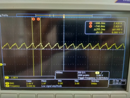

  • Hi Parker,
    I have measured the signal on STAT pin and there was 1Hz clock indicating charger fault condition.
    Then I have connected resistors on TS pins and programmed the temperature window & removed fault condition. Now my system is working fine on SYS power rail for this board.
    But I am getting saw-tooth kind of waveform on BAT pin. See attached image for BAT pin waveform. I have not connected battery till with Charger chip and CE pin is high (pulled high by 3.3V rail). Not able to understand why there is voltage available on BAT pin,
    At the same time, today on my other two boards I found SYS & BAT & GND pin shorted with each other(showing 1ohm impedance between SYS & BAT pin and 8ohm impedance between BAT/SYS & GND pin). These two boards Power management path (Vsys) were working fine till today. I have not connected battery to these boards.
    Any idea about this unpredictable behavior of charger chip.
    Appreciate your support here.
    Ritesh.
