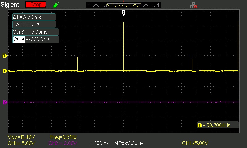

I am doing some testing with BQTesla Tx EVM, and I am wondering whether the frequency of the FOD ping (monitoring inrush current to detect object presence) can be increased? It seems like there is no reason it could not be done at a higher rate, apart from higher quiescent current draw. If not do you have any other solution to providing a higher speed object detection? I do not need any change to the actual Qi ping, just the short initial check. Please let me know if its possible.
